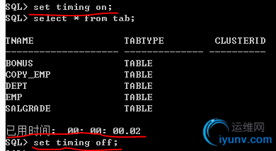

  使用set time/timing on,打开时间的开关
set time on;
set time off;
  使用set time/timing off,关闭时间的开关
set timing on;
set timint off;

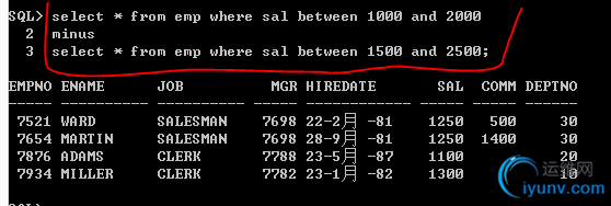

  使用差集运算[minus],查询工资在1000-2000,但不在1500-2500之间的员工信息(方式一)
select * from emp where sal between 1000 and 2000
minus
select * from emp where sal between 1500 and 2500;

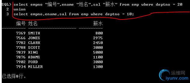

  4)当多个集合操作时,结果的列名由第一个集合列名决定
select empno "编号",ename "姓名",sal "薪水" from emp where deptno = 20
union
select empno,ename,sal from emp where deptno = 10;
