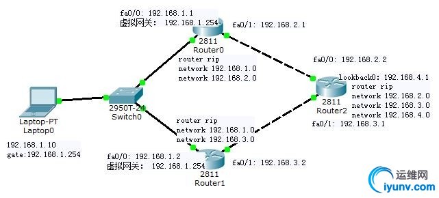

实验一:HSRP的配置(可以使用路由器或者三层交换机)
拓扑图
(1)配置IP地址和路由协议等
Router0(config)#interface fastEthernet 0/0
Router0(config-if)#ip address 192.168.1.1 255.255.255.0
Router0(config-if)#no shutdown
Router0(config)#interface fastEthernet 0/1
Router0(config-if)#ip address 192.168.2.1 255.255.255.0
Router0(config)#router rip
Router0(config-router)#network 192.168.1.0
Router0(config-router)#network 192.168.2.0
Router0(config-router)#passive-interface fastEthernet 0/0
Router1(config)#interface fastEthernet 0/0
Router1(config-if)#ip address 192.168.1.2 255.255.255.0
Router1(config-if)#no shutdown
Router1(config)#interface fastEthernet 0/1
Router1(config-if)#ip address 192.168.3.2 255.255.255.0
Router1(config)#router rip
Router1(config-router)#network 192.168.1.0
Router1(config-router)#network 192.168.3.0
Router1(config-router)#passive-interface fastEthernet 0/0
Router2(config)#interface loopback 0
Router2(config-if)#ip address 192.168.4.1 255.255.255.0
Router2(config-if)#no shutdown
Router2(config)#interface fastEthernet 0/0
Router2(config-if)#ip address 192.168.2.2 255.255.255.0
Router2(config)#interface fastEthernet 0/1
Router2(config-if)#ip address 192.168.3.1 255.255.255.0
Router2(config)#router rip
Router2(config-router)#network 192.168.2.0
Router2(config-router)#network 192.168.3.0
Router2(config-router)#network 192.168.4.0
(2)配置HSRP等
Router0(config-if)#standby 1 ip 192.168.1.254(启用HSRP功能,并配置虚拟IP地址,1为standby的组号。相同组号的路由器属于同一个HSRP组,所有属于同一个HSRP组的
                                             路由器的虚拟IP地址必须一致)
Router0(config-if)#standby 1 priority 120(配置HSRP优先级,如果不设置,默认是100,该值大的路由器会抢占为活跃的路由器)
Router0(config-if)#standby 1 preempt (该设置允许路由器在优先级是最高时成为活动路由器,如果不设置,即使该路由器权值再高也不会成为活动路由器)
Router0(config-if)#standby 1 timers 3 10 (此为默认值,可以不设置,若设置则所同一个HSRP组的路由器设置必须相同,3(秒)为hello时间,10(秒)为holdtime)
Router0(config-if)#standby 1 authentication md5 key-string xu(配置认证密码,防止非法设备加入到HSRP组中,同一个组的密码必须一致)
Router0(config-if)#standby 1 track fa0/1 30(配置端口跟踪)
Router1(config-if)#standby 1 ip 192.168.1.254
Router1(config-if)#standby 1 preempt
Router1(config-if)#standby 1 timers 3 10
Router1(config-if)#standby 1 authentication md5 key-string xu
(3)测试
Router#show  standby brief
Router#show  standby(显示详细信息)
