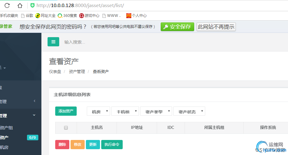

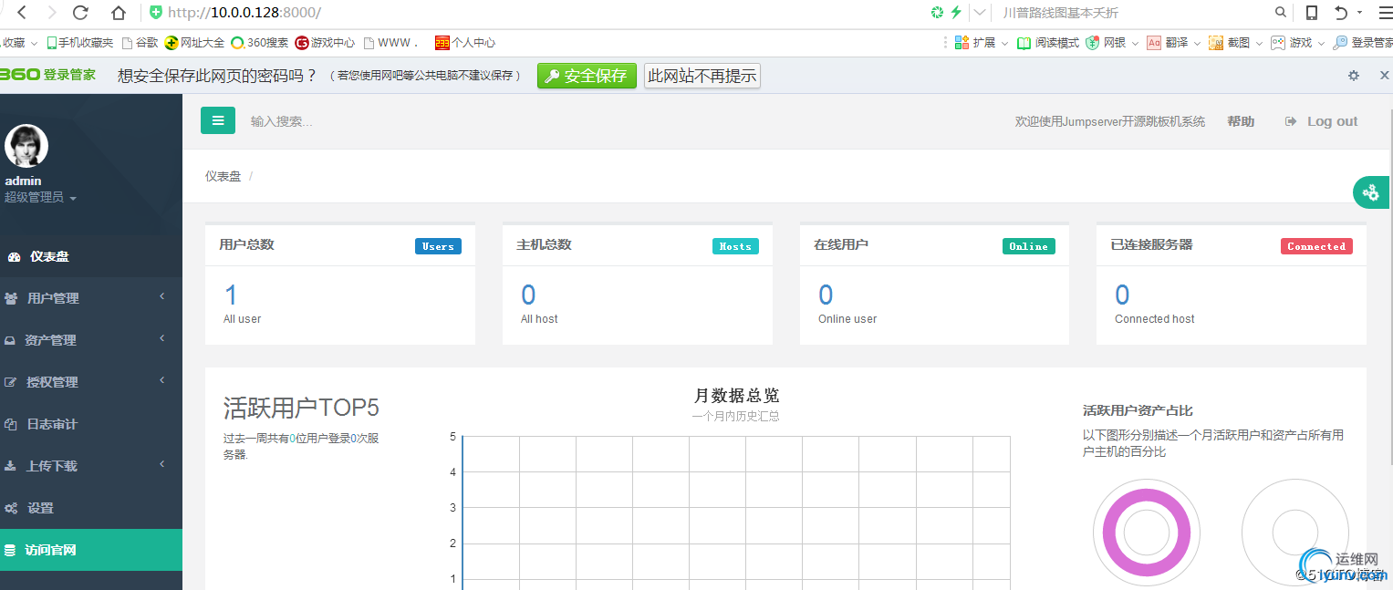

1.3部署web应用jumpserver
  jumpserver web 10.0.0.128(外) 172.168.1.128(内)
  jumpsever配置文件如下:
[root@localhost jumpserver]# cat /opt/jumpserver/jumpserver.conf
[base]
url = http://10.0.0.128
key = f1tty6elu8h03x2k
ip = 0.0.0.0  ###默认监听任何IP
port = 8000  ###为jumpsever的默认的web端口
log = debug
[db]
engine = mysql
host = 172.168.1.20  ####为虚拟VIP
port = 7001     ####为mysqlroute读写模式的默认端口
####jumpserver的连接数据库的地址
user = jumpserver
password = jumpserver
database = jumpserver
[mail]
mail_enable = 1
email_host = smtp@163.com
email_port = 25
email_host_user = tofox@163.com
email_host_password = weuidnre
email_use_tls = False
email_use_ssl = False
[connect]
nav_sort_by = ip
  启动jumpsever服务:
[root@localhost jumpserver]# /opt/jumpserver/service.sh stop
[root@localhost jumpserver]# /opt/jumpserver/service.sh start
[root@localhost jumpserver]# /opt/jumpserver/service.sh status
jumpserver is running...                                   [  OK  ]

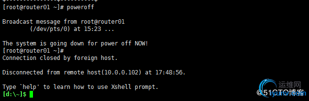

  一旦主keepalived程序关闭或者是服务器挂掉,这时虚拟VIP就可以实现跳跃到从keepalived机器上。
[root@router01 ~]# /etc/init.d/keepalived stop
Stopping keepalived:                                   [  OK  ]
[root@router01 ~]# ps -ef|grep keepalived
root       9540   9492  0 10:21 pts/3    00:00:00 grep keepalived
[root@router01 ~]#
[root@router02 ~]# ip a|grep 172.168.1.20
  inet 172.168.1.20/24 scope global secondary eth1
[root@router02 ~]#

5.2关闭10.0.0.102keepalive主机器router01测试高可用
  VIP172.168.1.20飘到10.0.0.104机器上
[root@router02 ~]#

  此时访问jumpserver web看是否可以正常登录?
  经测试是没问题的,jumpserver web可以正常打开的

  Jumpserver web依然可以继续打开
