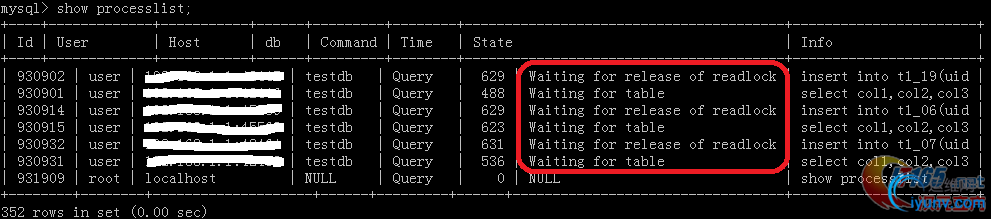

  最近业务高峰期间经常会有开发跳起来说应用连接数据库超时了!
  我们来看下mysql的运行状态
  Waiting for>
  The thread is waiting for a global read lock obtained by another thread (with FLUSH TABLES WITH READ LOCK) to be>  Waiting for table:等待表
  Waiting for tables, Waiting for table, Waiting for table flush
  The thread got a notification that the underlying structure for a table has changed and it needs to reopen the table to get the new structure. However, to reopen the table, it must wait until all other threads have closed the table in question.
  This notification takes place if another thread has used FLUSH TABLES or one of the following statements on the table in question: FLUSH TABLES tbl_name,>  In MySQL 5.5.6, Waiting for table was replaced with Waiting for table flush.
  线程获得一个通知,底层表结构已经发生变化,它需要重新打开表来获取新的结构。然而,重新打开表,它必须等到所有其他线程关闭这个有问题的表。
  这个通知产生通常因为另一个线程对问题表执行了FLUSH TABLES或者以下语句之一:FLUSH TABLES tbl_name, ALTER TABLE, RENAME TABLE, REPAIR TABLE, ANALYZE TABLE, or OPTIMIZE TABLE.

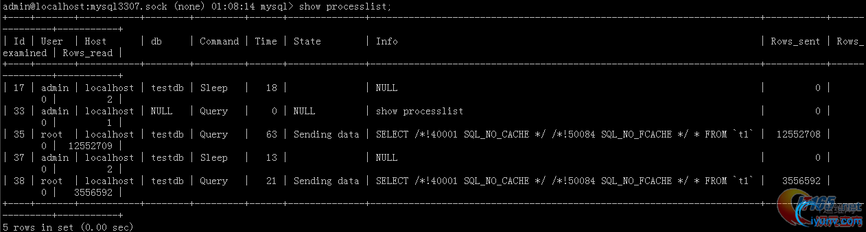

  我们来重现一下这个场景
  /usr/local/mysql/bin/mysqldump -u root -p  --skip-opt --master-data=2--single-transaction --add-drop-table --create-options --quick --extended-insert --set-charset --disable-keys --triggers -R --flush-logs --databases testdb > testdb.sql
  执行插入
  mysql> call insT1(10000000);
  30s后执行【如果同时执行,效果不明显】
  /usr/local/mysql/bin/mysqldump -u root -p  --skip-opt --master-data=2 --single-transaction --add-drop-table --create-options --quick --extended-insert --set-charset --disable-keys --triggers -R --flush-logs --databases testdb > testdb1.sql

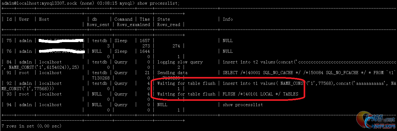

  执行插入
  mysql> call insT2(1000000);
  等待刷表

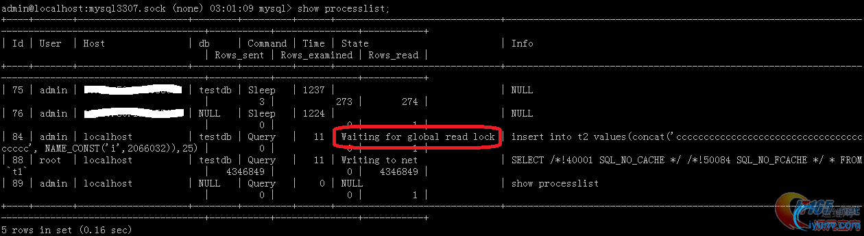

  不使用--single-transaction
  等待全局读锁释放
  结论:因为选用--master-data参数在SQL文件的头部会写入binlog和position信息,所以在执行备份前mysql需要执行flush tables,搭建过从库的同学都了解,我们在获取完整备份前都要执行FLUSH TABLES WITH READ LOCK;来获取这些主库当前信息,这里也是这样。 www.it165.net
