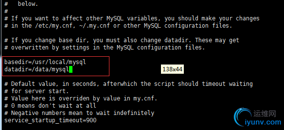

  10.编辑启动脚本:
  # vi /etc/init.d/mysqld定义basedir和datadir
  basedir=/usr/local/mysql
  datadir=/data/mysql
