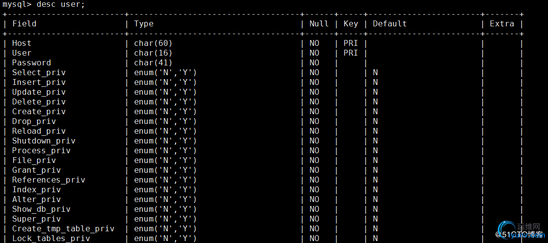

  2 再查看user字段,
  mysql> desc user;
