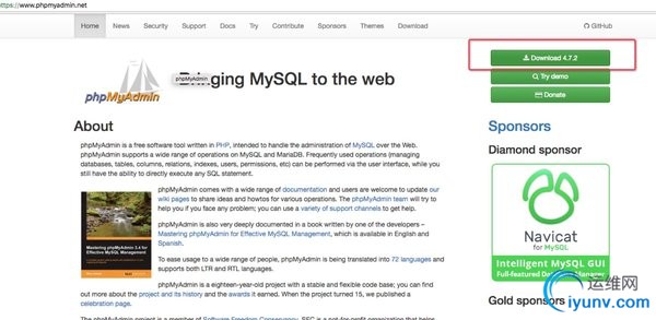

下载
  去官网地址 https://www.phpmyadmin.net/  ,目前最新版下载链接
https://files.phpmyadmin.net/phpMyAdmin/4.7.2/phpMyAdmin-4.7.2-all-languages.zip

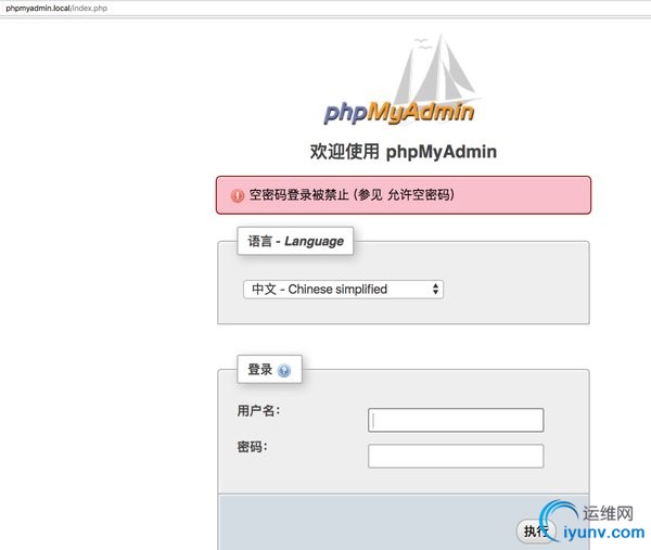

#找到这行代码 大概524行,将false 改为 true,表示允许空密码登录(在生产换行数据库一定要设置为false)
$cfg['Servers'][$i]['AllowNoPassword'] = false;
  如果AllowNoPassword没有设置为True,当密码为空的时候就会出现下图提示

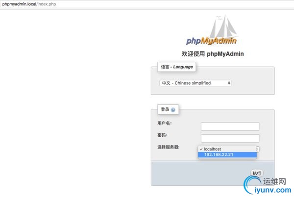

多Mysql实例配置
  多数据库实例 其实和单数据库是一样的,本身phpMyadmin就支持
#在 /home/vagrant/download/phpmyadmin 下有一个 config.sample.inc.php ,复制一个文件名是config.inc.php
#编辑config.inc.php,找到First server,将如下代码放在后面,最后结果如截图
$hosts = [
    1 => [ 'host' => 'localhost','user' => '','password' => '' ],
    2 => [ 'host' => '192.168.22.21','user' => '','password' => '' ],
foreach( $hosts as  $host_idx => $host_item  ){
    /* Authentication type */
    $cfg['Servers'][$host_idx]['auth_type'] = 'cookie';
    /* Server parameters */
    $cfg['Servers'][$host_idx]['user'] = $host_item['user'];
    $cfg['Servers'][$host_idx]['password'] = $host_item['password'];
    $cfg['Servers'][$host_idx]['host'] = $host_item['host'];
    $cfg['Servers'][$host_idx]['compress'] = false;
    $cfg['Servers'][$host_idx]['AllowNoPassword'] = true;
  config.inc.php截图
  效果截图,是不是很酷,哈哈
