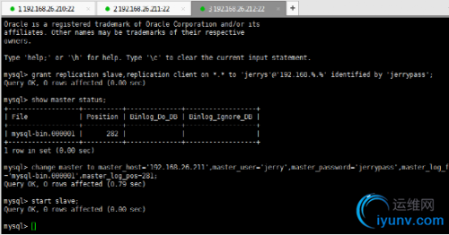

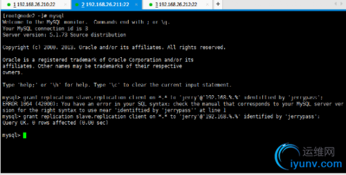

  创建远程所有权账号:
  grant replication slave,replication client on *.* to 'jerry'@'192.168.%.%'>

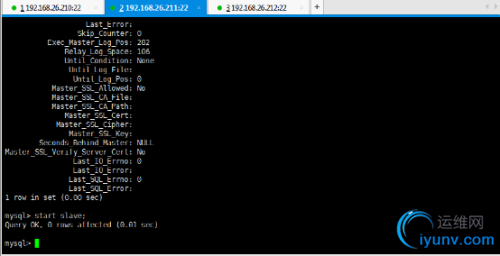

  change master to master_host='192.168.26.212',master_user='jerrys',master_password='jerrypass',master_log_file='mysql-bin.000001',master_log_pos=282;
  Start slave;

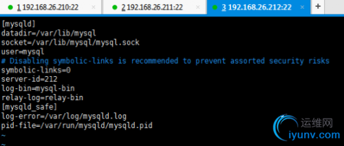

  Vim /etc/my.cnf
  配置文件如下:
  [mysqld]
  datadir=/var/lib/mysql
  socket=/var/lib/mysql/mysql.sock
  user=mysql
  # Disabling symbolic-links is recommended to prevent assorted security risks
  symbolic-links=0
  server-id=212
  log-bin=mysql-bin
  relay-log=relay-bin
  [mysqld_safe]
  log-error=/var/log/mysqld.log
  pid-file=/var/run/mysqld/mysqld.pid

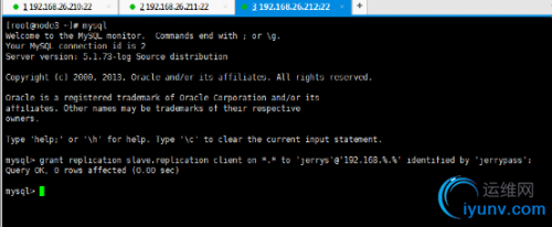

  授权远程访问账号:
  change master to master_host='192.168.26.211',master_user='jerry',master_password='jerrypass',master_log_file='mysql-bin.000001',master_log_pos=281;
  Start slave;

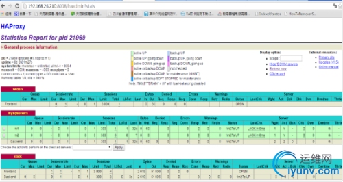

  frontend websrv *:3306
  default_backend mysqlservers
  balance  leastconn
  server m1 192.168.26.211:3306  check port 3306 maxconn 300
  server m2 192.168.26.212:3306  check port 3306 maxconn 300
  listen static
  mode  http
  bind *:8008
  stats enable
  stats uri /haadmin?stats
  stats auth admin:admin
  stats hide-version
  stats admin if TRUE
