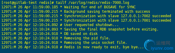

      redis-cli -h 127.0.0.1 -p 7000 shutdown
      查看master的redis日志信息
      tailf /var/log/redis/redis-7000.log
      在redis日志中可以看得到下线之前redis会做一个快照,将redis的数据保存到本地的磁盘中

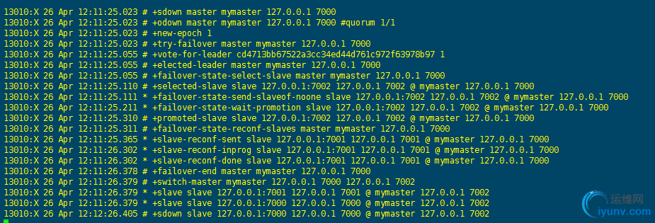

      查看sentinel的日志信息
      tailf /var/log/redis/redis-sentinel27000.log
  在日志中我们可以看到
  +sdown master mymaster 127.0.0.1 7000
  #sentinel将master标记为主观下线
  +odown master mymaster 127.0.0.1 7000 #quorum 1/1
  #sentinel将master标记为客观下线
  +new-epoch 1
  +try-failover master mymaster 127.0.0.1 7000
  +vote-for-leader cd4713bb67522a3cc34ed44d761c972f63978b97 1
  #开始投票
  +elected-leader master mymaster 127.0.0.1 7000
  +failover-state-select-slave master mymaster 127.0.0.1 7000
  +selected-slave slave 127.0.0.1:7002 127.0.0.1 7002 @ mymaster 127.0.0.1 7000
  +failover-state-send-slaveof-noone slave 127.0.0.1:7002 127.0.0.1 7002 @ mymaster 127.0.0.1 7000
  +failover-state-wait-promotion slave 127.0.0.1:7002 127.0.0.1 7002 @ mymaster 127.0.0.1 7000
  +promoted-slave slave 127.0.0.1:7002 127.0.0.1 7002 @ mymaster 127.0.0.1 7000
  +failover-state-reconf-slaves master mymaster 127.0.0.1 7000
  +slave-reconf-sent slave 127.0.0.1:7001 127.0.0.1 7001 @ mymaster 127.0.0.1 7000
  +slave-reconf-inprog slave 127.0.0.1:7001 127.0.0.1 7001 @ mymaster 127.0.0.1 7000
  +slave-reconf-done slave 127.0.0.1:7001 127.0.0.1 7001 @ mymaster 127.0.0.1 7000
  +failover-end master mymaster 127.0.0.1 7000
  +switch-master mymaster 127.0.0.1 7000 127.0.0.1 7002
  #设置新master服务器127.0.0.1 7002
  +slave slave 127.0.0.1:7001 127.0.0.1 7001 @ mymaster 127.0.0.1 7002
  +slave slave 127.0.0.1:7000 127.0.0.1 7000 @ mymaster 127.0.0.1 7002
  +sdown slave 127.0.0.1:7000 127.0.0.1 7000 @ mymaster 127.0.0.1 7002
  加入日志中出现上述红色字体信息则表明failover转移成功
