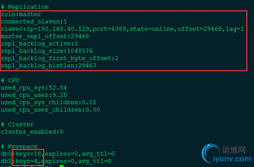

  4. 查看Replication信息
  Master:
  Slave:
