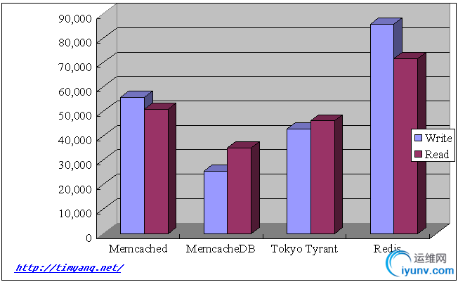

2. Small data>  Test 1, 1-5,000,000 as key, 100 bytes string value, do set, then get test, all get test has result.
  Request per second(mean)
StoreWriteReadMemcached55,989 50,974 Memcachedb25,583 35,260 Tokyo Tyrant42,988 46,238 Redis85,765 71,708  Server Load Average
StoreWriteReadMemcached1.80, 1.53, 0.871.17, 1.16, 0.83MemcacheDB1.44, 0.93, 0.644.35, 1.94, 1.05Tokyo Tyrant3.70, 1.71, 1.142.98, 1.81, 1.26Redis1.06, 0.32, 0.181.56, 1.00, 0.543. Larger data>  Test 2, 1-500,000 as key, 20k bytes string value, do set, then get test, all get test has result.

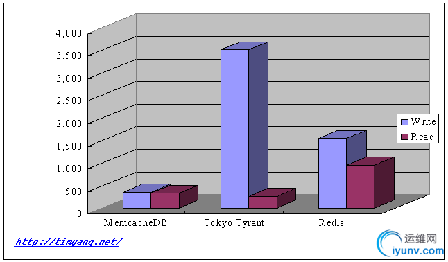

  (Aug 13 Update: fixed a bug on get() that read non-exist key)
StoreWriteReadMemcachedb357 327 Tokyo Tyrant3,501 257 Redis1,542 957 4. Some notes about the test
  When test Redis server, the memory goes up steadily, consumed all 8G and then use swap(and write speed slow down), after all memory and swap space is used, the client will get exceptions. So use Redis in a productive environment should limit to a small data>So compare Redis together with MemcacheDB/TC may not fair because Redis actually does not save data to disk during the test.
  Tokyo cabinet and memcachedb are very stable during heavy load, use very little memory in set test and less than physical memory in get test.
  MemcacheDB peformance is poor for write large data>  The call response time was not monitored in this test.
