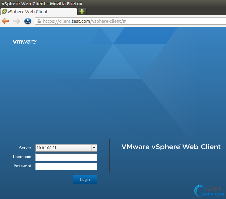

3 例子:
//代理 vmware vsphere web client 为例
URL  https://client.test.com/vsphere-client/
过程  client -> nginx 443 -> tomcat 443
1 nginx proxy
rhel5.4 192.168.57.71/10.0.100.71
2 tomcat  web client server
  windows 2k3 server 10.0.100.83
#nginx 代码
  • #nginx 代理相关参数
  • proxy_redirect off;
  • proxy_set_header Host $host;
  • proxy_set_header X-Real-IP $remote_addr;
  • proxy_set_header X-Forwarded-For $proxy_add_x_forwarded_for;
  • client_max_body_size 50m;
  • client_body_buffer_size 256k;
  • proxy_connect_timeout 30;
  • proxy_send_timeout 30;
  • proxy_read_timeout 60;
  • proxy_buffer_size 4k;
  • proxy_buffers 4 32k;
  • proxy_busy_buffers_size 64k;
  • proxy_temp_file_write_size 64k;
  • proxy_next_upstream error timeout invalid_header http_500 http_503 http_404;
  • proxy_max_temp_file_size 128m;
  • proxy_store on;
  • proxy_store_access user:rw group:rw all:r;
  • upstream vsphere_web_client
  •    server 10.0.100.83:443 weight=1 max_fails=2 fail_timeout=30s;
  • server {
  •         listen          443 ssl;
  •         server_name     client.test.com;
  •         access_log      /data/logs/client.test.com/access.log;
  •         error_log       /data/logs/client.test.com/error.log;
  •         ssl_certificate      ssl/server.crt;
  •         ssl_certificate_key  ssl/server.key;
  •         keepalive_timeout    60;
  •         if ($host !~ "client.test.com")
  •           return 403;
  •         location /
  •           proxy_pass  https://vsphere_web_client;
