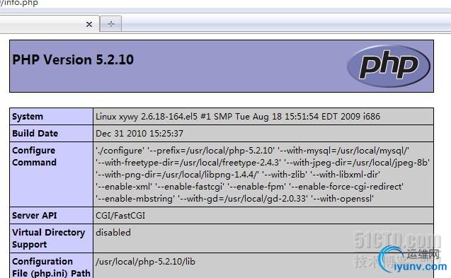

三、Nginx+PHP安装
1、PHP-CGI安装及配置
yum install libxml2-devel
  # tar -zxvf php-5.2.10.tar.gz -C /usr/local/src
  # cp /home/houzc/php-5.2.10-fpm-0.5.10.diff.gz /usr/local/src
  #cd /usr/local/src
  # gzip -cd php-5.2.10-fpm-0.5.11.diff.gz | patch -d php-5.2.10 -p1
  注:将php-fpm解压到php-5.2.10
  # cd /usr/local/src/php-5.2.10
  # ./configure
  --prefix=/usr/local/php-5.2.10 --with-mysql=/usr/local/mysql/ --with-freetype-dir=/usr/local/freetype-2.4.3  --with-jpeg-dir=/usr/local/jpeg-8b  --with-png-dir=/usr/local/libpng-1.4.4/ --with-zlib --with-libxml-dir --enable-xml --enable-fastcgi --enable-fpm  --enable-force-cgi-redirect --enable-mbstring //
  --with-gd=/usr/local/gd-2.0.33  --with-openssl
  # make && make install
  配置php-cgi
  # vi /usr/local/php-5.2.10/etc/php-fpm.conf
  Equivalent to Apache MaxClients directive.
    Equivalent to PHP_FCGI_CHILDREN environment in original php.fcgi
    Used with any pm_style.
    500
  //修改php进程的最大数为500进程
  Unix user of processes
    www
  Unix group of processes
    www
  //守护进程的用户
  启动php-cgi
  # echo “ulimit -SHn 65535” >> /etc/rc.loal
  # /usr/local/php-5.2.10/sbin/php-fpm start
  注:php-cgi进程,监听127.0.0.1的9000端口,进程数为500
  (如果服务器内存小于3GB,可以只开启64个进程),用户为www(上面的配置)
  php-fpm还有其他参数,包括:start|stop|quit|restart|reload|logrotate,修改php.ini后不重启php-cgi,重新加载配置文件使用reload
