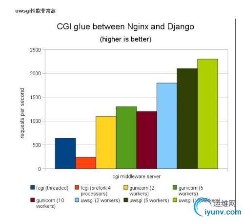

  uWSGI的主要特点如下
  1、超快的性能
  2、低内存占用(实测为apache2的mod_wsgi的一半左右)
  3、多app管理(终于不用冥思苦想下个app用哪个端口比较好了-.-)
  4、详尽的日志功能(可以用来分析app性能和瓶颈)
  5、高度可定制(内存大小限制,服务一定次数后重启等)
  总而言之uwgi是个部署用的好东东,正如uWSGI作者所吹嘘的:
  If you are searching for a simple wsgi-only server, uWSGI is not for you, but if you are building a real (production-ready) app that need to be rock-solid, fast and easy to distribute/optimize for various load-average, you will pathetically and morbidly fall in love (we hope) with uWSGI.
