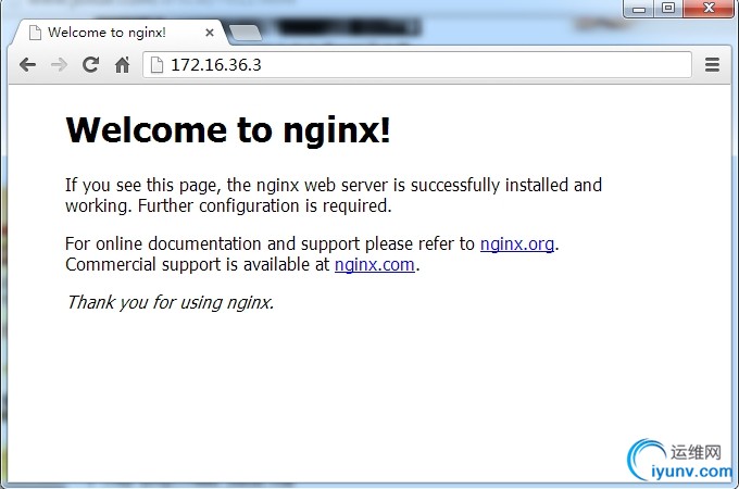

  启动服务:
  # service nginx star

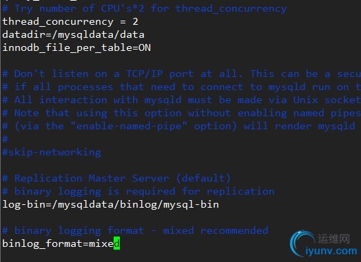

  提供配置文件
  # cp support-files/my-large.cnf /etc/my.cnf
  # vim /etc/my.cnf
  thread_concurrency = 2
  datadir=/mysqldata/data
  innodb_file_per_table=ON
  log-bin=/mysqldata/binlog/master-bin
  binlog_format=mixd
