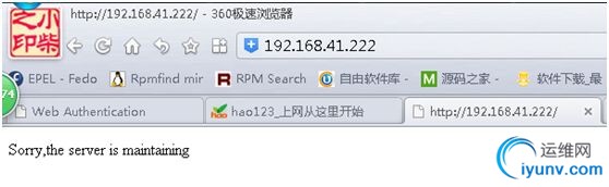

  [root@node1 ~]# service nginx start
  正在启动 nginx:                                           [确定]
  [root@node1 ~]# service keepalived start
  正在启动 keepalived:                                     [确定]

  [root@node3 ~]# service httpd stop
  停止httpd:                                              [确定]
  [root@node4 ~]# service httpd stop
  停止 httpd:                                              [确定]
  再次刷新页面
  [root@node3 ~]# service httpd start
  正在启动 httpd:                                           [确定]
  [root@node4 ~]# service httpd start
  正在启动 httpd:                                           [确定]
  [root@node1 ~]# service keepalived stop
  停止 keepalived:                                          [确定]
  再次访问网页正常

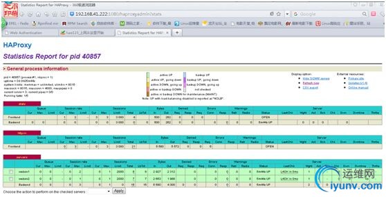

  listen stats
  mode http
  bind 0.0.0.0:1080
  stats enable
  stats hide-version
  stats uri     /haproxyadmin?stats
  stats realm   Haproxy\ Statistics
  stats auth    admin:admin
  stats admin if TRUE

  [root@node1 ~]# service haproxy start
  正在启动 haproxy:                                         [确定]
