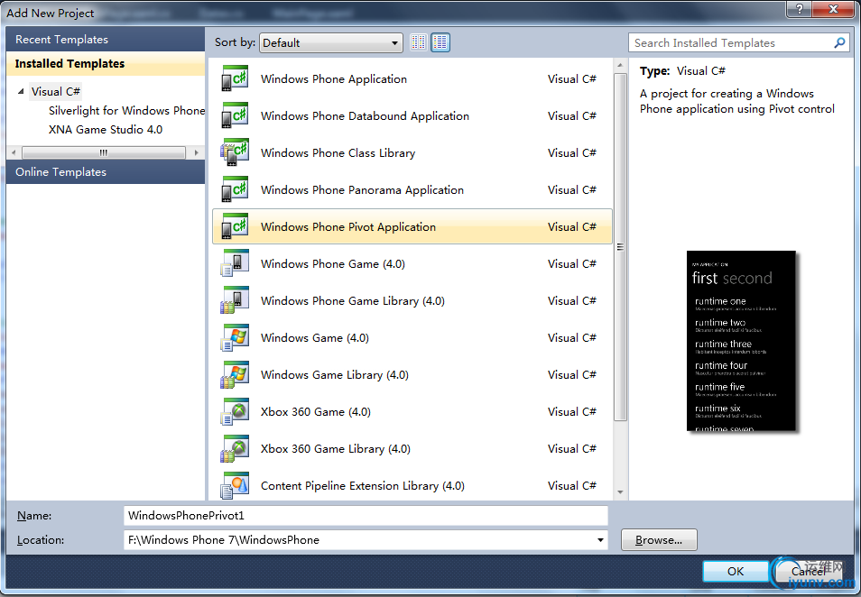

  1.新建项目有两种方法
  如图1、图2
  图1
  图2

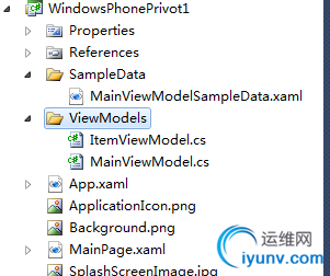

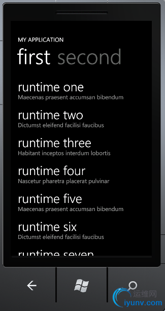

  如果使用图2新建项目,那么它会自动生成Pivot的项目模板,如下图,这样就简化了我们的步骤。本人建议使用这种新建项目的方法。
  图3
  图4

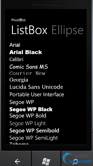

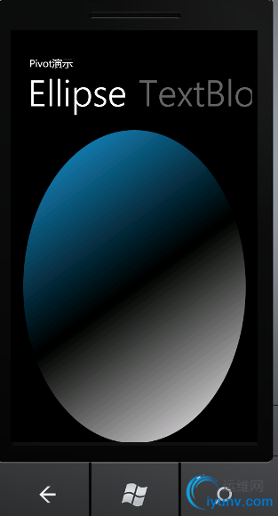

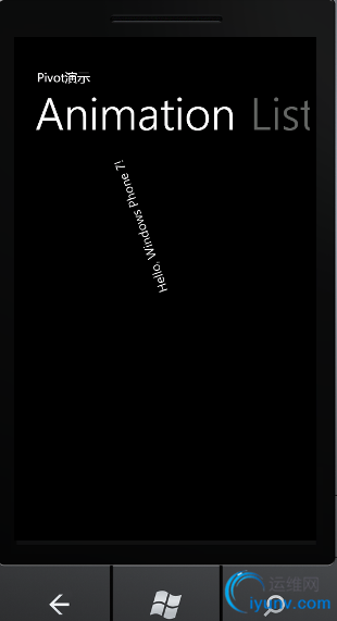

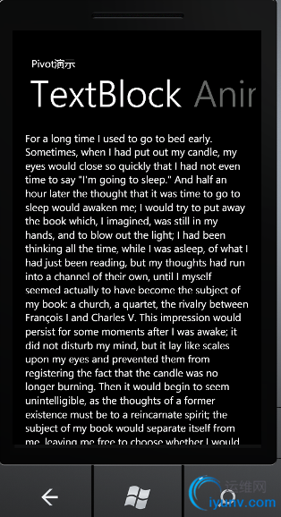

  从工具箱中拖Pivot控件到视图工作区,在本例中一共有四页,第一页是一个ListBox控件,第二页是一个Ellipse控件,第三页是一个多行文本区域控件(TextBlock),第四页是一个具有动画效果的文本,我们可以通过左右滑动来进行换页
                        Arial
                        Arial Black
                        Calibri
                        Comic Sans MS
                        Courier New
                        Georgia
                        Lucida Sans Unicode
                        Portable User Interface
                        Segoe WP
                        Segoe WP Black
                        Segoe WP Bold
                        Segoe WP Light
                        Segoe WP Semibold
                        Segoe WP SemiLight
                        Tahoma
                        Times New Roman
                        Trebuchet MS
                        Verdana
                        Webdings
                    For a long time I used to go to bed early. Sometimes, when I had put out
                    my candle, my eyes would close so quickly that I had not even time to
                    say "I'm going to sleep." And half an hour later the thought that it was
                    time to go to sleep would awaken me; I would try to put away the book
                    which, I imagined, was still in my hands, and to blow out the light; I
                    had been thinking all the time, while I was asleep, of what I had just
                    been reading, but my thoughts had run into a channel of their own,
                    until I myself seemed actually to have become the subject of my book:
                    a church, a quartet, the rivalry between François I and Charles V. This
                    impression would persist for some moments after I was awake; it did not
                    disturb my mind, but it lay like scales upon my eyes and prevented them
                    from registering the fact that the candle was no longer burning. Then
                    it would begin to seem unintelligible, as the thoughts of a former
                    existence must be to a reincarnate spirit; the subject of my book would
                    separate itself from me, leaving me free to choose whether I would form
                    part of it or no; and at the same time my sight would return and I
                    would be astonished to find myself in a state of darkness, pleasant and
                    restful enough for the eyes, and even more, perhaps, for my mind, to
                    which it appeared incomprehensible, without a cause, a matter dark
                    indeed.
  效果如图

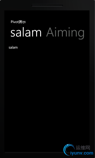

  3.数据绑定
  数据源类
  public static class Datas
        public static List GetDatas()
            List list = new List();
            list.Add("salam");
            list.Add("Aiming Zhang");
            return list;
  绑定数据

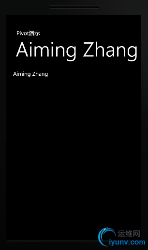

  this.pivot.ItemsSource = Datas.GetDatas();
  效果如下
