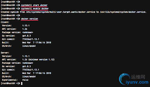

  Install Docker on CentOS 7 using the yum command below.
  yum -y install docker
  After the installation is complete, start the service and add it to the boot time.
  systemctl start docker
  systemctl enable docker
  Docker installed on the rancher host server - check it using commands below.
  systemctl status docker
  docker --version
  And you will get the result as shown below.

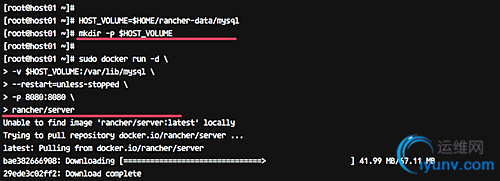

  Before installing Rancher server on 'host01' server, we will create and define a new directory as a Rancher database volume.
  Run the commands below.
  HOST_VOLUME=$HOME/rancher-data/mysql
  mkdir -p $HOST_VOLUME
  Now install Rancher server using the docker command below.
  sudo docker run -d \
  -v $HOST_VOLUME:/var/lib/mysql \
  --restart=unless-stopped \
  -p 8080:8080 \
  rancher/server
  Wait for the Rancher server installation.

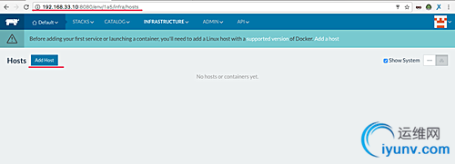

  When the installation is complete, Rancher server is accessible from the web browser.
  Open your web browser and type the server IP address with port 8080.
  http://192.168.33.10:8080/
  And you will get the Rancher first page installation as below.
  Rancher server has been installed on CentOS 7 server and is now running on default port 8080.

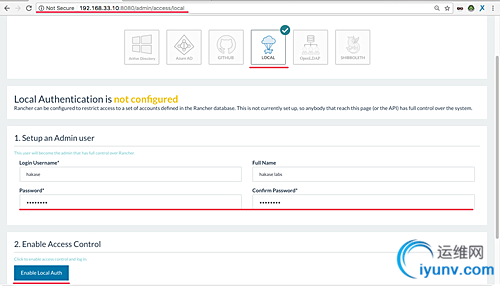

  Move your cursor to the 'ADMIN' menu drop-down and click the 'Access Control'.
  Now we want to use the 'Local Authentication' method. Click 'LOCAL' on the page, then type your username and password.
  Click 'Enable Local Auth' button and you will be redirected to the Rancher admin dashboard.
  Access Control for the Rancher server has been setup with Local Authentication enabled.

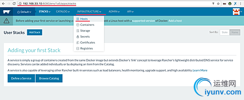

  Open the Rancher Dashboard, move your cursor to the 'INFRASTRUCTURE' menu and click 'Hosts'.
  Now click the 'Add Host' button.

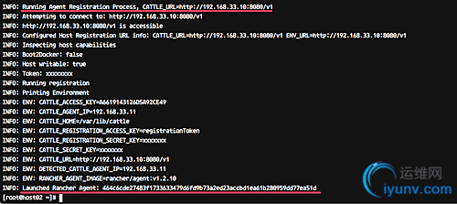

  Now open the host02 terminal shell and paste the following command.
  sudo docker run -e CATTLE_AGENT_IP="192.168.33.11"  --rm --privileged -v /var/run/docker.sock:/var/run/docker.sock -v /var/lib/rancher:/var/lib/rancher rancher/agent:v1.2.10 http://192.168.33.10:8080/v1/scripts/BCF2EFCA73A02954EBDF:1514678400000:OdRDdvnEUbV2hUMAFIS3oQxcTt4
  The command will download and run new container for Rancher Agent.
  And when it's complete, you will get the result as shown below.

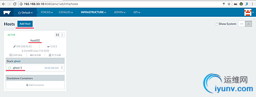

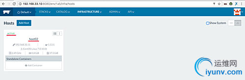

  Now back to the Rancher Dashboard Host Add page and click the 'Close' button.
  And you will see the 'host02' on the page as shown below.
  host02 has been added to the Rancher server, and we're now ready to run container managed by Rancher server.

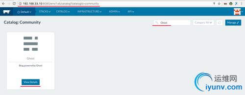

  On the Rancher Dashboard, move the cursor to the 'CATALOG' menu and click the Community Catalog.
  In the 'Search' box, type the application name that we want to install ('Ghost').
  Click the 'View Details' button.

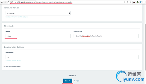

  Give the new Ghost container a name and description.
  Then click the 'Launch' button.
  When it's complete, you will get the result as below.

  Now move your cursor to the 'INFRASTRUCTURE' menu and click 'Host'. Now make sure you get the 'ghost' container is running on the 'host2' server.

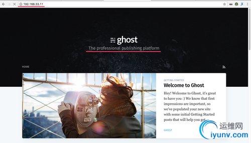

  To verify the Ghost container installation, open your web browser and type the 'host02' IP address and you will get the ghost blog default homepage.
  http://192.168.33.11/
  Rancher server and Rancher agent installation on Ubuntu 16.04 has been completed successfully.
