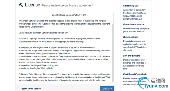

  Now, open your web browser and type the URL http://yourdomain.com, you will be redirected to the AbanteCart installation wizard as shown in the following image:
  Here, Agree to the License agreement and click on the Continue button, you should see the following page:

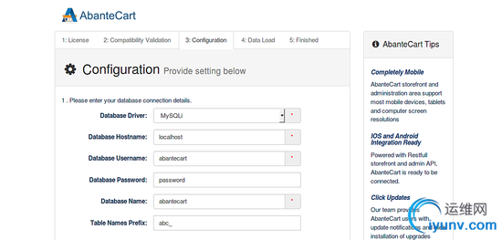

  Here, provide your Database name, Database username, Database password, Admin username, and password, then click on the Continue button to start the installation. Once the installation is completed, you should see the following page:

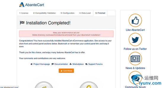

  Now, click on the Login to your Control Panel button, you will be redirected to AbanteCart login page as shown below:
  Provide your admin credential and click on the Login button, you should see the AbanteCart Dashboard in the following image:
