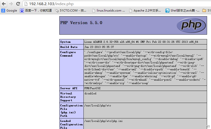

  11、配置ngin支持php:
   编辑nginx的主配置文件:
location / {
            root   html;
            index  index.html index.htm index.php;    //添加index.php
//启用下面的配置
location ~ \.php$ {
            root           html;
            fastcgi_pass   127.0.0.1:9000;
            fastcgi_index  index.php;
            fastcgi_param  SCRIPT_FILENAME  /scripts$fastcgi_script_name;
            include        fastcgi_params;
   编辑fastcgi_params参数,将里面的内容全部替换为以下内容:
#vim /etc/nginx/fastcgi_params
fastcgi_param  GATEWAY_INTERFACE  CGI/1.1;
fastcgi_param  SERVER_SOFTWARE    nginx;
fastcgi_param  QUERY_STRING       $query_string;
fastcgi_param  REQUEST_METHOD     $request_method;
fastcgi_param  CONTENT_TYPE       $content_type;
fastcgi_param  CONTENT_LENGTH     $content_length;
fastcgi_param  SCRIPT_FILENAME    $document_root$fastcgi_script_name;

   添加php测试页面:
[iyunv@ASANGE ~]# vim /usr/html/index.php
<?php
phpinfo();
浏览器上访问:
[Shell] 纯文本查看 复制代码
