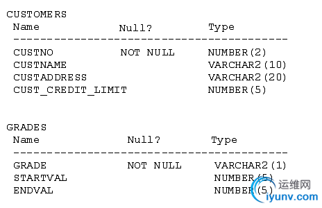

141. View the Exhibitand examine the structure of CUSTOMERS and GRADES tables.
You need to displaynames and grades of customers who have the highest credit limit.
Which two SQL statementswould accomplish the task? (Choose two.)
A. SELECT custname,grade
FROM customers, grades
WHERE (SELECTMAX(cust_credit_limit)
FROM customers) BETWEENstartval and endval;
B. SELECT custname,grade
WHERE (SELECT MAX(cust_credit_limit)
FROM customers)
AND cust_credit_limitBETWEEN startval AND endval;
C. SELECT custname,grade
WHERE cust_credit_limit= (SELECT MAX(cust_credit_limit)
FROM customers)
D. SELECT custname,grade
FROM customers , grades
WHERE cust_credit_limitIN (SELECT MAX(cust_credit_limit)
FROM customers)
ANDMAX(cust_credit_limit) BETWEEN startval AND endval;
Answer: BC
解析:
题意:You need to display names and grades of customers whohave the highest credit limit 意思要求找出最高credit limit 但是须在startval endval 之间,执行where后的条件从右到左

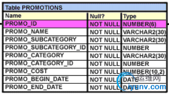

142. View the Exhibitand examine the structure of the PRODUCTS table.
Evaluate the followingquery:
SQL> SELECT prod_name
FROM products
WHERE prod_id IN (SELECTprod_id FROM products
WHERE prod_list_price =
(SELECT MAX(prod_list_price)FROM products
WHERE prod_list_price  ALL (SELECT promo_begin_date
FROM promotions
WHERE promo_category ='INTERNET');
D. SELECT promo_name,promo_begin_date FROM promotions
WHERE promo_begin_date> ANY (SELECT promo_begin_date
FROM promotions
Answer: C
解析:
FROM promotions
得到类别为internet的所有promo_begin_date
WHERE promo_begin_date> ALL (SELECT promo_begin_date
FROM promotions
大于所有的类别为internet的所有promo_begin_date,即大于最大的,也就是最近的
时间的比较,越大说明离当前时间越近

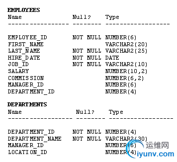

166. View the Exhibitand examine the structures of the EMPLOYEES and DEPARTMENTS tables.
You want to update theEMPLOYEES table as follows:4 ? 4;
-Update only thoseemployees who work in Boston or Seattle (locations 2900 and 2700).
-Set department_id forthese employees to the department_id corresponding to London (location_id
2100).
-Set the employees'salary in location_id 2100 to 1.1 times the average salary of their department.
-Set the employees'commission in location_id 2100 to 1.5 times the average commission of their
department.
You issue the followingcommand:
SQL>UPDATE employees
SET department_id =
(SELECT department_id
FROM departments
WHERE location_id =2100),
(salary, commission) =
(SELECT 1.1*AVG(salary),1.5*AVG(commission)
FROM employees,departments
WHEREdepartments.location_id IN(2900,2700,2100))
WHERE department_id IN
FROM departments
WHERE location_id = 2900
OR location_id = 2700)
What is the outcome?
A. It executessuccessfully and gives the correct result.
B. It executessuccessfully but does not give the correct result.
C. It generates an errorbecause a subquery cannot have a join condition in an UPDATE statement.
D. It generates an errorbecause multiple columns (SALARY, COMMISION) cannot be specified together
Answer: B
解析:
无语法错误
条件给错,WHEREdepartments.location_id=2100

168. View the Exhibitand examine the description of SALES and PROMOTIONS tables.
You want to delete rowsfrom the SALES table, where the PROMO_NAME column in the PROMOTIONS
table has either blowoutsale or everyday low price as values.
Which DELETE statementsare valid? (Choose all that apply.)
A. DELETE
FROM sales
WHERE promo_id = (SELECTpromo_id
FROM promotions
WHERE promo_name ='blowout sale')
AND promo_id = (SELECTpromo_id
FROM promotions
WHERE promo_name ='everyday low price');
B. DELETE
FROM sales
FROM promotions
OR promo_id = (SELECTpromo_id
FROM promotions
C. DELETE
FROM sales
WHERE promo_id IN(SELECT promo_id
FROM promotions
OR promo_name ='everyday low price');
D. DELETE
FROM sales
FROM promotions
WHERE promo_name IN('blowout sale','everyday low price'));
Answer: BCD
解析:
题意:You want to delete rows from the SALES table, where thePROMO_NAME column in the PROMOTIONS  tablehas either blowout sale oreverydaylow price as values.
意思要求找出promo_name 为blowout sale或everyday lowprice的
所以
B,C,D选项正确
