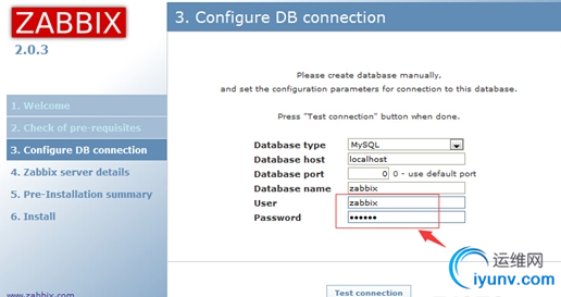

七。安装
http://www.zabbix.com/setup.php
报错
zabbix  PHP time zone unknown   Fail
解决:
#vim /usr/local/php5/etc/php.ini
         date.timezone = PRC
#servicephp-fpm reload
