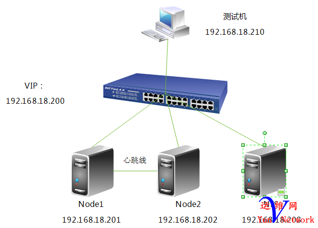

二、拓扑准备
说明:拓扑与上几篇博客一致,这里就不详细说明了。

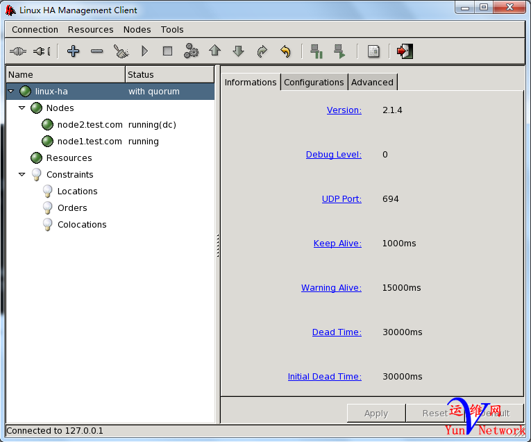

5.查看一下集群状态
注:两个节点都在线,资源暂时还没有配置。
6.测试一下hb_gui图形配置界面
[iyunv@node1 ~]# hb_gui &
[1] 20377

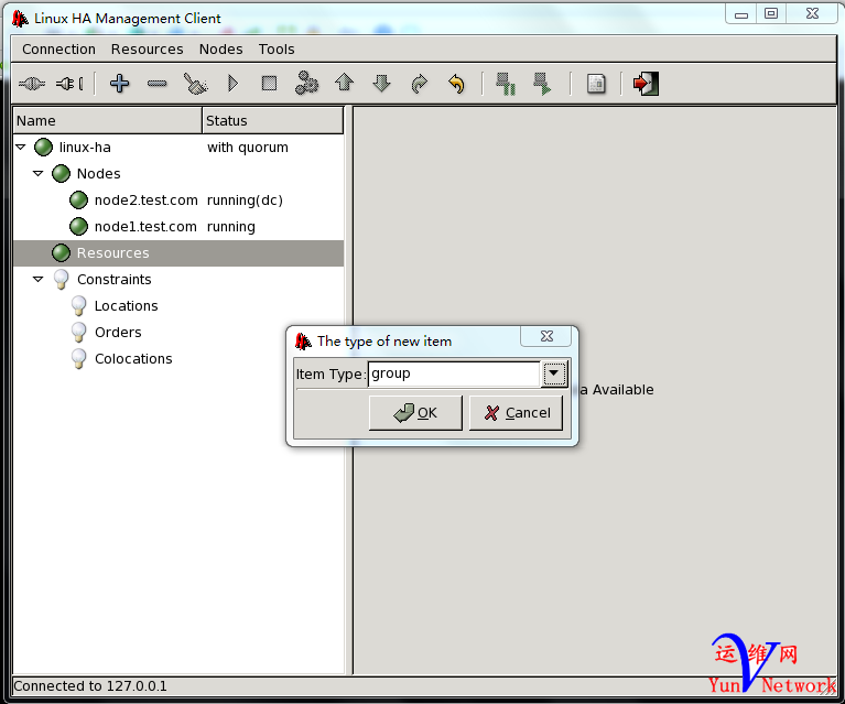

1.新建组资源
2.给组资源增加ID名

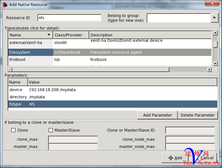

3.增加vip资源

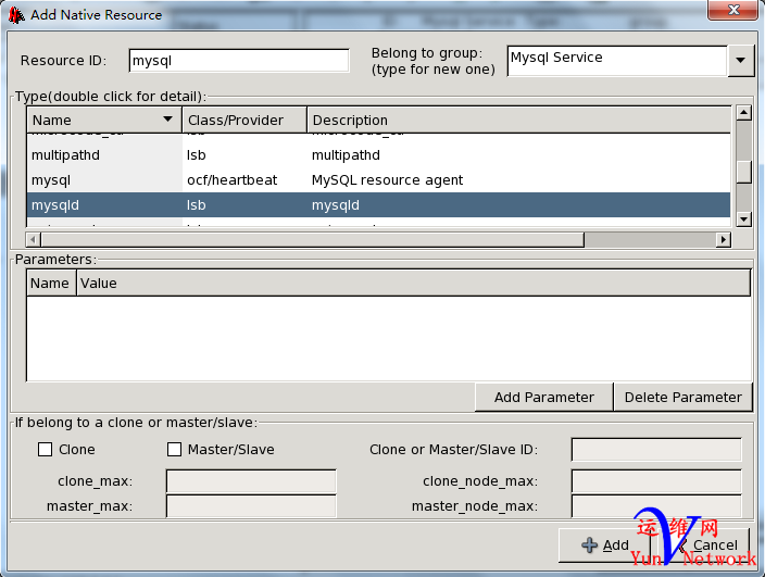

4.增加共享存储资源
5.增加mysql服务资源

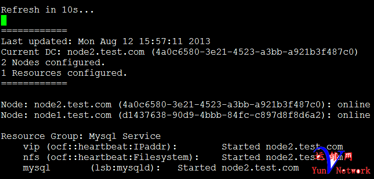

6.资源增加完成
7.启动全部资源

10.查看一下资源状态
说明:从图中可以看出,所有资源全部运行在node2上,现在我们就去访问一下mysql服务

(3).node1上查看一下IP
[iyunv@node1 ~]# ifconfig
eth0      Link encap:Ethernet  HWaddr 00:0C:29:23:76:4D
          inet addr:192.168.18.201  Bcast:192.168.18.255  Mask:255.255.255.0
          inet6 addr: fe80::20c:29ff:fe23:764d/64 Scope:Link
          UP BROADCAST RUNNING MULTICAST  MTU:1500  Metric:1
          RX packets:285092 errors:0 dropped:0 overruns:0 frame:0
          TX packets:319282 errors:0 dropped:0 overruns:0 carrier:0
          collisions:0 txqueuelen:1000
          RX bytes:155185716 (147.9 MiB)  TX bytes:297534308 (283.7 MiB)
eth0:0    Link encap:Ethernet  HWaddr 00:0C:29:23:76:4D
          inet addr:192.168.18.200  Bcast:192.168.18.255  Mask:255.255.255.0
lo        Link encap:Local Loopback
          inet addr:127.0.0.1  Mask:255.0.0.0
          inet6 addr: ::1/128 Scope:Host
          UP LOOPBACK RUNNING  MTU:16436  Metric:1
          RX packets:63015 errors:0 dropped:0 overruns:0 frame:0
          TX packets:63015 errors:0 dropped:0 overruns:0 carrier:0
          collisions:0 txqueuelen:0
          RX bytes:46067195 (43.9 MiB)  TX bytes:46067195 (43.9 MiB)
(4).node1上测试访问一下mysql
[iyunv@node1 ~]# mysql
Welcome to the MySQL monitor.  Commands end with ; or \g.
Your MySQL connection id is 1
Server version: 5.5.33-log MySQL Community Server (GPL)
Copyright (c) 2000, 2013, Oracle and/or its affiliates. All rights reserved.
Oracle is a registered trademark of Oracle Corporation and/or its
affiliates. Other names may be trademarks of their respective
owners.
Type 'help;' or '\h' for help. Type '\c' to clear the current input statement.
mysql> show databases;
| Database           |
| information_schema |
| mydb               |
| mysql              |
| performance_schema |
| test               |
5 rows in set (0.02 sec)
(5).远程测试连接一下mysql
[iyunv@nfs ~]# /usr/local/mysql/bin/mysql -uroot -p123456 -h 192.168.18.200
Your MySQL connection id is 2
owners.
| Database           |
| mydb               |
| mysql              |
| test               |
5 rows in set (0.01 sec)

     <resources>
       <group id="Mysql Service">
         <meta_attributes id="Mysql Service_meta_attrs">
           <attributes>
             <nvpair id="Mysql Service_metaattr_target_role" name="target_role"value="started"/>
             <nvpair id="Mysql Service_metaattr_ordered" name="ordered" value="true"/>
             <nvpair id="Mysql Service_metaattr_collocated" name="collocated" value="true"/>
           </attributes>
         </meta_attributes>
         <primitive id="vip" class="ocf" type="IPaddr" provider="heartbeat">
           <instance_attributes id="vip_instance_attrs">
             <attributes>
               <nvpair id="880a5e57-0d7b-448d-adb2-27191987f2bd" name="ip"value="192.168.18.200"/>
               <nvpair id="9ede4882-ab99-4450-9828-b89bc8d43df4" name="nic" value="eth0"/>
               <nvpair id="9179225c-a7f3-4190-8f7b-4d6012498e59" name="cidr_netmask"value="24"/>
             </attributes>
           </instance_attributes>
         </primitive>
         <primitive id="nfs" class="ocf" type="Filesystem" provider="heartbeat">
           <instance_attributes id="nfs_instance_attrs">
             <attributes>
               <nvpair id="0615970e-633d-41a6-acd7-d6823c73d701" name="device"value="192.168.18.208:/mydata"/>
               <nvpair id="4e2146f8-3890-40a8-8340-6e2787979a60" name="directory"value="/mydata"/>
               <nvpair id="b7a1d528-a43f-4a46-bee9-fcb7b7b40ee6" name="fstype" value="nfs"/>
             </attributes>
           <meta_attributes id="nfs_meta_attrs">
             <attributes/>
           </meta_attributes>
         </primitive>
         <primitive id="mysql" class="lsb" type="mysqld" provider="heartbeat">
           <meta_attributes id="mysql_meta_attrs">
             <attributes/>
           </meta_attributes>
         </primitive>
       </group>
