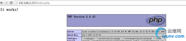

测试LAMP环境
1.测试httpt和php的结合
编译安装的httpd默认文档位置为/usr/local/apache/htdocs
编辑如下文件
vi index.php
<html><body><h1>It works!</h1></body></html>
<?php
phpinfo();

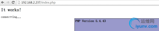

QQ截图20150721084147.png 2.测试httpd-php-mysql结合
vi index.php
<?php
$conn=mysql_connect('localhost','root','79635075');
if (!$conn)
        echo "Could not connet...";
else
        echo "connectting,,,";
