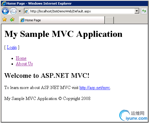

  Now, I can hit CTRL+F5 (or browse my website) and I should see the following home page.
  And about page.
  Notice that the URLs contain the .mvc extension.
