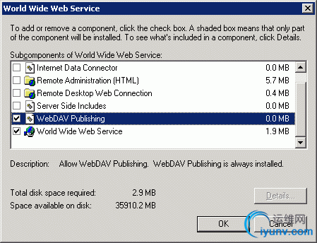

  First we need to install WebDAV on the server. Note that when you promote a Windows Server 2003 machine to the role of Application Server, it installs various IIS 6 components but WebDAV isn’t one of these components installed. This is different from the earlier Windows 2000 Server platform where installing IIS 5 automatically installed WebDAV as well. To install WebDAV on the IIS 6 machine, use Add or Remove Programs in Control Panel and run the Windows Components Wizard. You can find WebDAV under Application Server | Internet Information Services | World Wide Web Service | WebDAV Publishing:

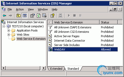

  Once you’ve installed WebDAV, you need to ensure it is enabled. To verify this, check the WebDAV option under the Web Service Extensions node in IIS Manager:
Note that when you allow the WebDAV extension (httpext.dll) you are allowing it for all websites on your server. IIS unfortunately does not let you enable WebDAV on a per-website basis.

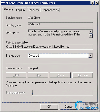

  The next step is to enable WebDAV on the client machines that will be used to create and manage content for your website. Windows XP has a built-in WebDAV client that doesn’t need to be installed, only enabled. To enable WebDAV on XP, open the Services console under Administrative Tools and find the WebClient service and double-click on this service to open its Properties sheet:
  Change the Startup Type to Automatic, then click the Start button to get the service running. You’re ready to start publishing content to your web server.

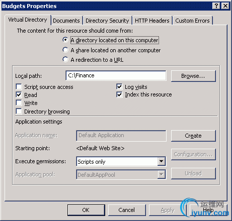

  Now let’s configure the web permissions for this virtual directory so users can publish content. This is done on the Virtual Directory tab of the Properties sheet for the virtual directory:
  As you can see from the figure, by default only Read permission is enabled for the virtual directory. This won’t do as it means users will be able to read content in the directory but not upload or edit content. To publish content using WebDAV, you should enable the following web permissions on the directory:
  • Read - lets users read what has been published to the server
  • Write - lets users upload new content to the server and edit existing content on the server
  • Directory listing - lets users view a list of published files on the server so they can select the one they want to view or edit.

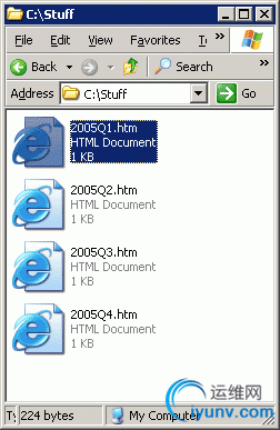

  Let’s try out our setup and see if it works. On an XP client machine I have a directory named C:\Stuff with four HTML files in it:

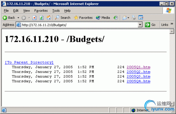

  Now I simply select the four HTML files in my C:\Stuff window and drag them into my open Web Folder, and WebDAV does its magic. To verify that the files have been published, I can open the same URL http://server/Budgets again in Internet Explorer but this time as a normal web site (i.e. do not select the “Open as Web Folder” option). Here is the result:
