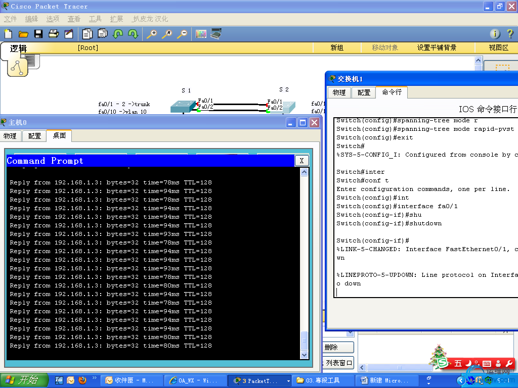

五、测试
当主链路处于down状态时,能够自动的切换到备份链路,保证数据的正常转发。
在S2上shutdown 掉 fa0/1
Switch#conf t
Enter configuration commands, one per line.  End with CNTL/Z.
Switch(config)#int
Switch(config)#interface fa0/1
Switch(config-if)#shu
Switch(config-if)#shutdown                                         //shutdown fa0/1端口
Switch(config-if)#
%LINK-5-CHANGED: Interface FastEthernet0/1, changed state to administratively down
%LINEPROTO-5-UPDOWN: Line protocol on Interface FastEthernet0/1, changed state to down
Switch#show spanning-tree
VLAN0001
  Spanning tree enabled protocol rstp
  Root ID    Priority    32769
             Address     0001.63E2.4A7A
             This bridge is the root
             Hello Time  2 sec  Max Age 20 sec  Forward Delay 15 sec
  Bridge ID  Priority    32769  (priority 32768 sys-id-ext 1)
             Aging Time  20
Interface        Role Sts Cost      Prio.Nbr Type
Fa0/1            Desg FWD 19        128.1    P2p
Fa0/2            Desg FWD 19        128.2    P2p
VLAN0010
  Root ID    Priority    32778
  Bridge ID  Priority    32778  (priority 32768 sys-id-ext 10)
             Aging Time  20
Fa0/10           Desg FWD 19        128.10   P2p
Switch#
PC1:
PC>ipconfig
IP Address......................: 192.168.1.2
Subnet Mask.....................: 255.255.255.0
Default Gateway.................: 192.168.1.1
PC>ping -t 192.168.1.3
Pinging 192.168.1.3 with 32 bytes of data:
Reply from 192.168.1.3: bytes=32 time=78ms TTL=128
Reply from 192.168.1.3: bytes=32 time=94ms TTL=128
Reply from 192.168.1.3: bytes=32 time=93ms TTL=128
Reply from 192.168.1.3: bytes=32 time=62ms TTL=128
Reply from 192.168.1.3: bytes=32 time=79ms TTL=128
