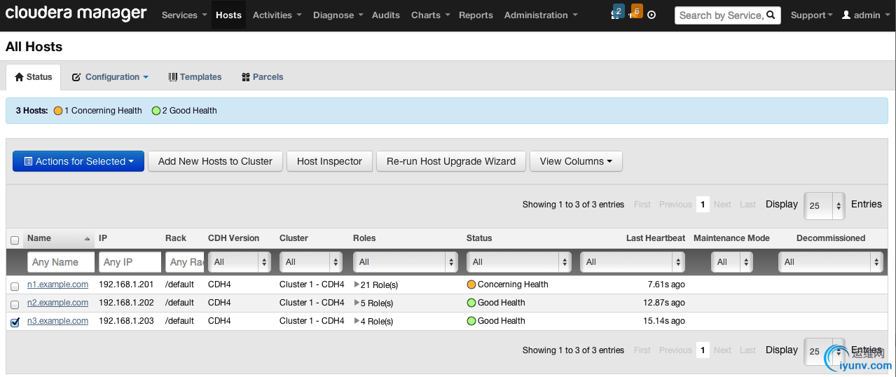

Decommission one or more hosts:
  • Click the Hosts tab.
  • Select the host(s) you want to decommission.
  • From the Actions for Selected menu, click Decommission.

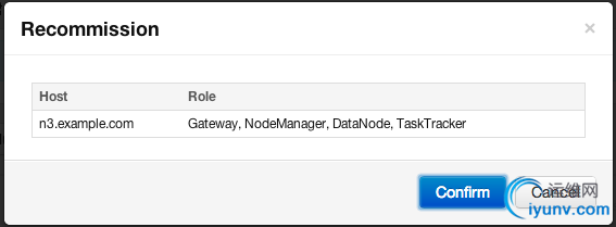

Recommissioning a Host
Only hosts that are decommissioned using Cloudera Manager can be recommissioned.
  • Select the host(s) you want to recommission.

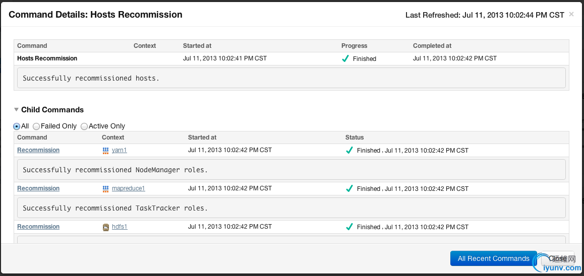

  • From the Actions for Selected menu, click recommission.
This will recommission the host (i.e. remove it from the exclusion lists and run the appropriate refresh) so that the roles that reside on it can be restarted. The Decommissioned indicator is removed from the host. It also removes the Decommissioned indicator from the roles that reside on the host. However, the roles themselves are NOT restarted by the recommission command.

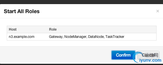

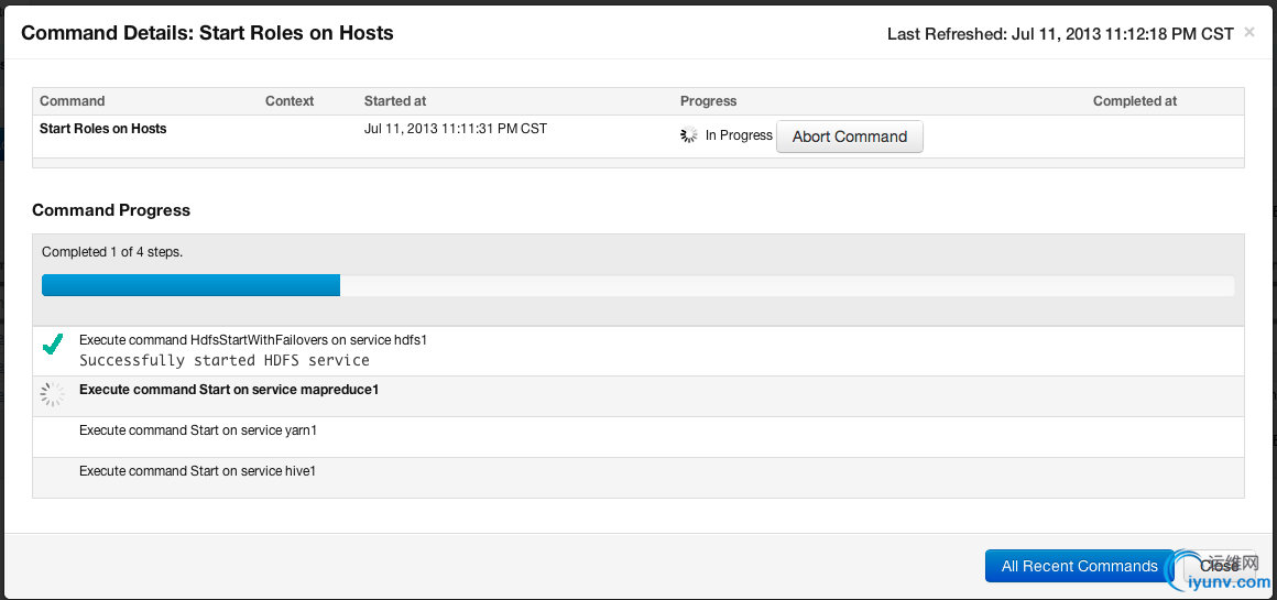

You can restart all the roles on a recommissioned host in a single command from the Hosts page:
  • Select the host(s) on which you want to start the decommissioned roles.
  • From the Actions for Selected menu, click Start All Roles.

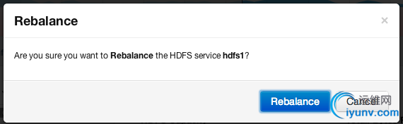

  Run the Balancer to rebalance the cluster:
  1. On the HDFS > Status tab, choose Rebalance on the Actions menu.
  2. Click Rebalance that appears in the next screen to confirm.
 If you see a Finished status, the Balancer
successfully ran and completed.
