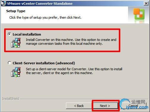

  It is a very easy installation, click Next and follow the wizard, agreeing to the terms of the license agreement, select the default installation folder, and select Local installation
  • VMware vCenter Converter Standalone 5.1 - Local Installation

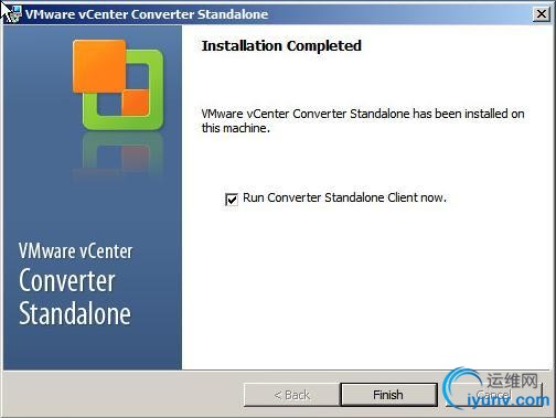

  Click Next, and follow the installation wizard to the end, and Click Finish.
  • VMware vCenter Converter Standalone 5.1 - Finish
  If you left the Tick in the Box for Run Converter Standalone Client now. VMware vCenter Converter Standalone will start, otherwise you will need to click the icon on your desktop.  2   Creating a P2V (V2V in this example) for synchronization

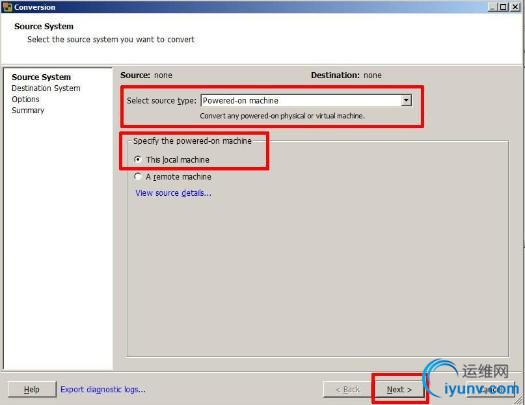

  Select the Default option
Select source type: Powered-on-machine
Specify the powered-on machine: This local machine
followed by Next to continue, converter will identify the source machine.

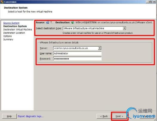

  Select destination type: VMware Infrastructure machine
Enter the destination server, username and password, in this example, I'm using our VMware vSphere vCenter server details, but if you wanted to synchronize/replicate to a standalone VMware vSphere Hypervisor (ESXi) host, you would enter the VMware vSphere Hypervisor (ESXi)  host details here, e.g. root username and password.

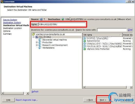

  • VMware vCenter Converter Standalone 5.1 - Specify Destination Machine name
  Specify the destination name of the machine followed by Next

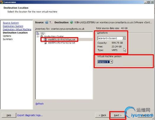

  • VMware vCenter Converter Standalone 5.1 - Specify Destination Location
  Specify the destination location for the machine followed by Next, if you are using a VMware vSphere vCenter Server and have a VMware Cluster created, you will have additional options to specify which VMware vSphere Hypervisor (ESXi) host to create the new virtual machine, also specify the datastore location. Ensure the virtual machine version matches the original VM, in this example v8.0.

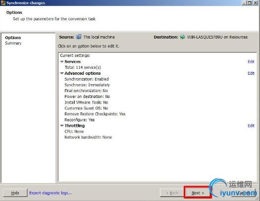

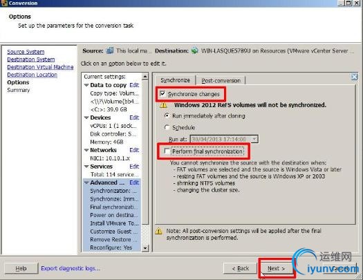

To enable the Synchronize function, you MUST select Edit
  • VMware vCenter Converter Standalone 5.1 - Enable Synchronise
  Ensure Synchronize changes is selected and ticked.
Ensure Perform final synchronization is Un-ticked.

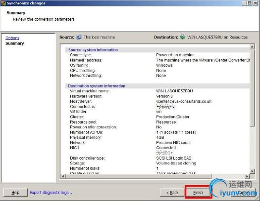

If you wanted to perform, a Scheduled Synchronize, select and set the Schedule Option. Select Next to continue, review the Summary screen, and select Finish.
  • VMware vCenter Converter Standalone 5.1 - Summary Screen

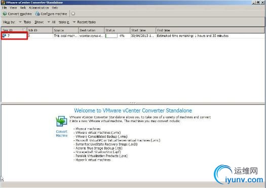

  A P2V job will be submitted and the P2V conversion will start.
  • VMware vCenter Converter Standalone 5.1 - P2V Job Submitted

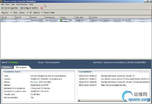

  If you click the Task Id, you can check on the Task Progress.
  • VMware vCenter Converter Standalone 5.1 - Task Progress
  If you are finding conversions time are long, see my EE Article, on how to imporve transfer times.

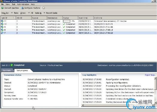

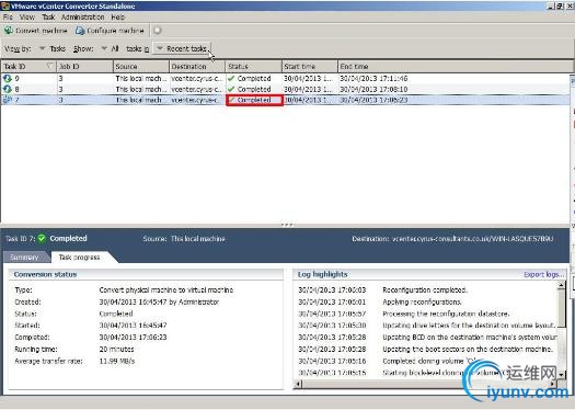

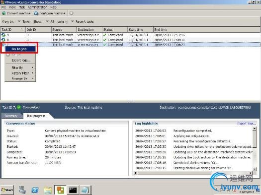

  Once the initial P2V (V2V) conversion has completed, or "seeded" a new virtual machine, you can use the Synchronize function to replicate any changes that occur on the source machine to the virtual machine, the source machine could be a physical or virtual machine. (You can check the virtual machine by disconnecting networking, and powering up the virtual machine).
  • VMware vCenter Converter Standalone 5.1 - Job Status
  The Job Status should state Completed. Right Click the Task Id and select Go to job
  • VMware vCenter Converter Standalone 5.1 - Go to Job

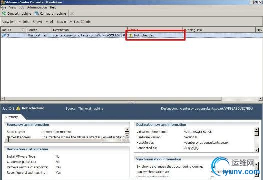

  You will notice that the Status states Not Scheduled, this is because we did not set a schedule.
  • VMware vCenter Converter Standalone 5.1 - Not Scheduled
  Right Click the Job Id, and select Synchronize.

  • VMware vCenter Converter Standalone 5.1 - Synchronize Task Progress
  You will notice your Synchronize Job is Running, and it will have a new Synchronize icon, next to the job. All changes in the source machine will be synchronized or replicated to the virtual machine.
Congratulations you have successfully created a P2V (V2V) and Synchronized (replicated) your machine to a virtual machine.
