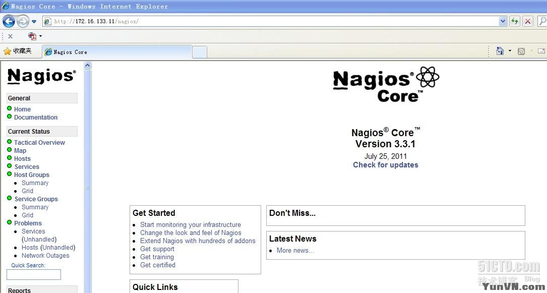

(4).通过web界面查看nagios:
http://172.16.133.11/nagios
登录时需要指定前面设定的web认证帐号和密码。

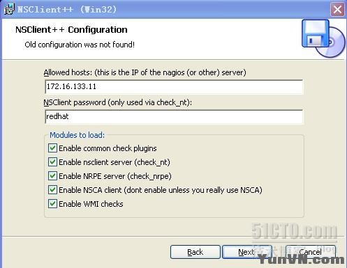

1.基于NSClient++监控本地主机windows(ip:172.16.132.1)
windows:
(1).安装NSClient++
允许哪个ip地址访问
node1:

(3).设置监控
检测系统运行时间
  • ./check_nt -H 172.16.132.1 -p 12489 -v UPTIME -s redhat
检测cpuload
  • ./check_nt -H 172.16.132.1 -p 12489 -v CPULOAD -w(警告比例) 80 -c(紧急比例)(检测参数)5,80,90 -s redhat
    90 -l
检测磁盘
  • ./check_nt -H 172.16.132.1 -p 12489 -v USEDDISKSPACE -w 80 -c 90 -l C -s redhat

②.定义主机
编辑/usr/local/nagios/etc/objects/windows.cfg
添加或修改为如下(主机名修改一致):
  • define host{
  •         use             windows-server
  •         host_name       winhost
  •         alias           My Windows Host
  •         address         172.16.132.1
  • .,$s/winserver/winhost/g
启用windows配置文件
  • vim /usr/local/nagios/etc/nagios.cfg
  •     cfg_file=/usr/local/nagios/etc/objects/windows.cfg
  • /usr/local/nagios/bin/nagios -v /usr/local/nagios/etc/nagios.cfg
登录网页http://172.16.133.11/nagios

打开网页http://172.16.133.11/nagios,点击service,有的可能要等会刷新
