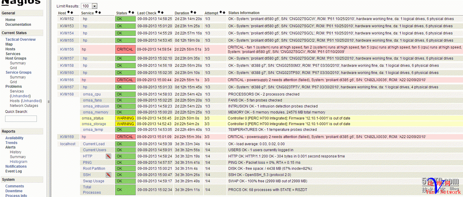

然后在监控服务器测试
/usr/local/nagios/libexec/check_hpasm -H 172.16.8.15 -C public

然后在监控服务器测试
/usr/local/nagios/libexec/check_openmanage -H 172.16.8.18 -C public

安装已完成

        check_command       omsa_memory
        service_description omsa_status
        check_command omsa_status
define service {
        use                 generic-service
        host_name           KVM168,KVM158,KVM160,KVM166,KVM167,KVM169
        service_description  omsa_cpu
        check_command       omsa_cpu
define service {
        use                 generic-service
        service_description  omsa_temp
        check_command       omsa_temp
define service {
        use                 generic-service
        service_description  omsa_storage
        check_command       omsa_storage
define service {
        use                 generic-service
        service_description  omsa_intrusion
        check_command       omsa_intrusion
define service {
        use                 generic-service
        service_description  omsa_fans
        check_command       omsa_fans
define service {
        use                 generic-service
        service_description  omsa_memory
配置nagios.cfg
vim /usr/local/nagios/etc/nagios.cfg
cfg_file=/usr/local/nagios/etc/objects/commands.cfg
cfg_file=/usr/local/nagios/etc/objects/contacts.cfg
cfg_file=/usr/local/nagios/etc/objects/timeperiods.cfg
cfg_file=/usr/local/nagios/etc/objects/templates.cfg
cfg_file=/usr/local/nagios/etc/objects/services.cfg
# Definitions for monitoring the local (Linux) host
cfg_file=/usr/local/nagios/etc/objects/localhost.cfg
cfg_file=/usr/local/nagios/etc/objects/linux.cfg
重启服务service nagios stop
测试有无报错
/usr/local/nagios/bin/nagios -v /usr/local/nagios/etc/nagios.cfg
无报错就可以启动服务
service nagios start
