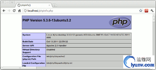

  To test whether the PHP 5 has been successfully installed or not, create a file phpinfo.php and copy the following content (to the file) -
<?php
print_r (phpinfo());
  and put the file in root web directory (/var/www). Then open the address http://localhost/phpinfo.php, then it should display the php configuration details like this -
  That’s All.. Linux (Ubuntu is itself a Linux based OS), Apache, MySQL and PHP i.e all the components of LAMP has been installed successfully.
