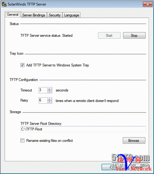

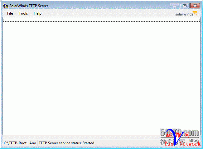

1.Setup TFTP file server by run Cisco TFTP Serversoftware, or other TFTP Server software(e.g.SolarWindsTFTPServer) and set the root directory.
Cisco TFTP:
SolarWinds TFTP Server:
