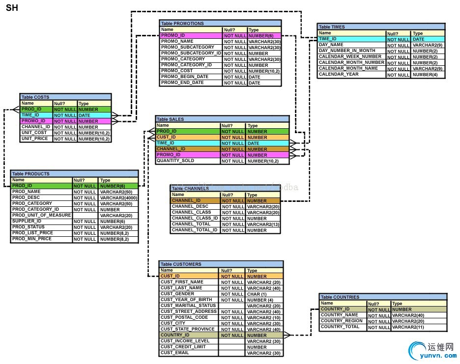

1. View the Exhibit andexamine the structure of the SALES, CUSTOMERS, PRODUCTS, and TIMES
tables.
The PROD_ID column isthe foreign key in the SALES table, which references the PRODUCTS table.
Similarly, the CUST_IDand TIME_ID columns are also foreign keys in the SALES table referencing the
CUSTOMERS and TIMEStables, respectively.
Evaluate the followingCREATE TABLE command:
CREATE TABLEnew_sales(prod_id, cust_id, order_date DEFAULT SYSDATE)
AS
SELECT prod_id, cust_id,time_id
FROM sales;
Which statement is trueregarding the above command?
http://blog.iyunv.com/zbdba/article/details/17053631http://blog.iyunv.com/zbdba/article/details/17053631 Center.jpg
A. The NEW_SALES tablewould not get created because the DEFAULT value cannot be specified in the
column definition.
B. The NEW_SALES tablewould get created and all the NOT NULL constraints defined on the specified
columns would be passedto the new table.
C. The NEW_SALES tablewould not get created because the column names in the CREATE TABLE
command and the SELECTclause do not match.
D. The NEW_SALES tablewould get created and all the FOREIGN KEY constraints defined on the
specified columns wouldbe passed to the new table.
Answer: B
解析:题目意思是利用:
AS
FROM sales;
创建表能否传递sales表的非空约束限制和外键约束
测试:
create table zbcxy
id number(20) not null,
sno number(10) unique,
sex char(2) check (sex in('男','女')),
cno number(6) references student(cno)
create table zbdba
as
select * from zbcxy;
erwei@ORCL>desc zbdba;
名称
ID          not null  number(20)
SNO                                number(10)
SEX                         char(2)
CNO                                   number(6)
经过一系列插入数据操作,发现只有非空约束才能传递。

8. View the Exhibit andexamine the structure of the CUSTOMERS table.
Which two tasks wouldrequire subqueries or joins to be executed in a single statement? (Choose two.)
A. listing of customerswho do not have a credit limit and were born before 1980
B. finding the number ofcustomers, in each city, whose marital status is 'married'
C. finding the averagecredit limit of male customers residing in 'Tokyo' or 'Sydney'
D. listing of thosecustomers whose credit limit is the same as the credit limit of customersresiding in the
city 'Tokyo'
E. finding the number ofcustomers, in each city, whose credit limit is more than the average creditlimit of
all the customers
Answer: DE
解析:
该题的意思是哪些选项需要用子查询或者join连接,很容易看出。

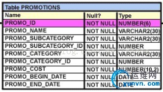

10. View the Exhibit; examine the structure of the PROMOTIONS table.
Each promotion has a durationof at least seven days .
Your manager has askedyou to generate a report, which provides the weekly cost for each promotion
done to l date.
Which query wouldachieve the required result?
A. SELECT promo_name,promo_cost/promo_end_date-promo_begin_date/7
FROM promotions;
B. SELECTpromo_name,(promo_cost/promo_end_date-promo_begin_date)/7
FROM promotions;
C. SELECT promo_name,promo_cost/(promo_end_date-promo_begin_date/7)
FROM promotions;
D. SELECT promo_name, promo_cost/((promo_end_date-promo_begin_date)/7)
FROM promotions;
Answer: D
解析:这个题就是涉及到优先级的问题,括号里面的优先执行
结束日期减去开始日期除以7得到星期数,再用总值除以星期数就是每个星期的

13. View the Exhibit andexamine the structure of the PRODUCTS table.
You need to generate areport in the following format:
CATEGORIES
5MP Digital Photo Camera'scategory is Photo
Y Box's category isElectronics
Envoy Ambassador'scategory is Hardware
Which two queries wouldgive the required output? (Choose two.)
A. SELECT prod_name ||q'' || 's category is ' || prod_category CATEGORIES
FROM products;
B. SELECT prod_name || q'['s] || 'category is ' ||  prod_categoryCATEGORIES
FROM products;
C. SELECT prod_name || q'\'s\'  ||  'category is '  || prod_categoryCATEGORIES
FROM products;
D. SELECT prod_name || q'<'s>'  || 'category is ' ||  prod_category CATEGORIES
FROM products;
Answer: CD

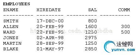

17. View the E xhibitand examine the data in the EMPLOYEES table.
You want to generate areport showing the total compensation paid to each employee to date.
You issue the followingquery:
SQL>SELECT ename||  ' joined on ' || hiredate ||
', the totalcompensation paid is ' ||
TO_CHAR(ROUND(ROUND(SYSDATE-hiredate)/365)* sal + comm)
"COMPENSATION UNTILDATE"
FROM emp;
What is the outcome?
A. It generates an errorbecause the alias is not valid.
B. It executessuccessfully and gives the correct output.
C. It executessuccessfully but does not give the correct output.
D. It generates an errorbecause the usage of the ROUND function in the expression is not valid.
E. It generates an errorbecause the concatenation operator can be used to combine only two items.
Answer: C
解析:能正确执行,但是不能得到正确的结果
scott@ORCL>
scott@ORCL>SELECTename ||  ' joined on ' || hiredate ||
  2  ',the total compensation paid is ' ||
  3 TO_CHAR(ROUND(ROUND(SYSDATE-hiredate)/365) * sal + comm)
  4 "COMPENSATION UNTIL DATE"
  5  FROMemp;
SMITH joined on 17-12月-80, the total compensation paid is
ALLEN joined on 20-2月 -81, the total compensation paid is 52960
WARD joined on 22-2月 -81, the total compensation paid is 41750
JONES joined on 02-4月 -81, the total compensation paid is
MARTIN joined on 28-9月 -81, the total compensation paid is 41400
BLAKE joined on 01-5月 -81, the total compensation paid is
CLARK joined on 09-6月 -81, the total compensation paid is
SCOTT joined on 19-4月 -87, the total compensation paid is
KING joined on 17-11月-81, the total compensation paid is
TURNER joined on 08-9月 -81, the total compensation paid is 48000
ADAMS joined on 23-5月 -87, the total compensation paid is
JAMES joined on 03-12月-81, the total compensation paid is
FORD joined on 03-12月-81, the total compensation paid is
MILLER joined on 23-1月 -82, the total compensation paid is
已选择14行。
发现奖金为空的,最后得不到结果
scott@ORCL>select1000+comm from emp where empno=7369;
1000+COMM
在oracle中如果如果不出来空值,任何数相加都会得到空值
scott@ORCL>select1000+nvl(comm,0) from emp where empno=7369;
1000+NVL(COMM,0)
            1000
18. Examine thestructure of the PROMOTIONS table:
name Null Type
PROMO_ID NOT NULLNUMBER(6)
PROMO_NAME NOT NULLVARCHAR2(30)
PROMO_CATEGORY NOT NULLVARCHAR2(30)
PROMO_COST NOT NULLNUMBER(10,2)
The management wants tosee a report of unique promotion costs in each promotion category.
A. SELECT DISTINCTpromo_cost, promo_category FROM promotions;
B. SELECTpromo_category, DISTINCT promo_cost FROM promotions;
C. SELECT DISTINCTpromo_cost, DISTINCT promo_category FROM promotions;
D. SELECT DISTINCTpromo_category, promo_cost FROM promotions ORDER BY 1;
Answer: D
解析:distinct后的字段顺序不同,得到的结果顺序也不同,但是最终的内容都是一样的,所以A和D的差别主要是order by 1的区别,下面我们看看它的作用:
使用前:
