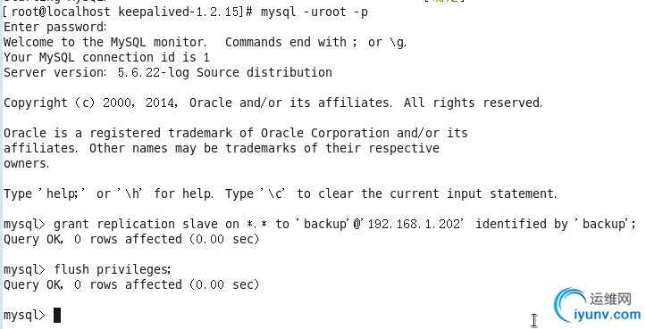

[iyunv@localhost /]# service mysqld restart  登录Mysql,增加一个账号专门用户同步:
[iyunv@localhost /]# mysql -uroot -p  #初始密码为空到Enter password:处直接回车即可
mysql> grant replication slave on *.* to 'backup'@'192.168.1.202' identified by 'backup';
mysql> flush privileges;
