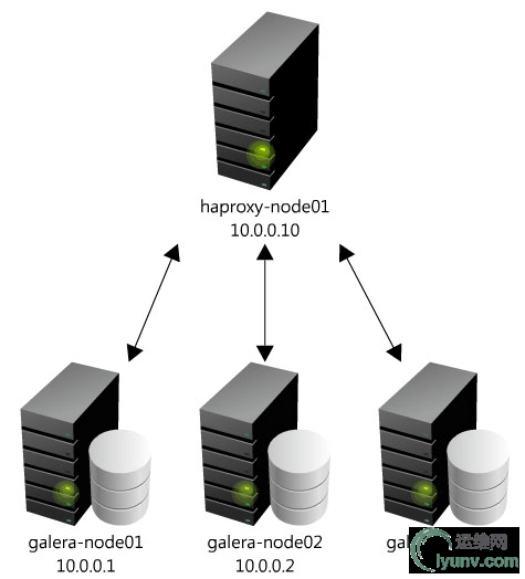

  I will re-use my last Galera configuration, here the architecture I set up:

listen galera_cluster 0.0.0.0:3306
mode tcp
balance roundrobin
option tcpka
option mysql-check user haproxy
server galera-node01 10.0.0.1:3306 check weight 1
server galera-node02 10.0.0.2:3306 check weight 1
server galera-node03 10.0.0.3:3306 check weight 1

  Does HAProxy work?
ubuntu@haproxy-node01:~$ sudo netstat -plantu | grep 3306
tcp        0      0 0.0.0.0:3306            0.0.0.0:*               LISTEN      3729/haproxy
  Round-robin effects:
ubuntu@haproxy-node01:~$ mysql -uroot -proot -h127.0.0.1 -e "show variables like 'wsrep_node_name' ;"
| Variable_name   | VALUE         |
| wsrep_node_name | galera-node01 |
| wsrep_node_name | galera-node02 |
| wsrep_node_name | galera-node03 |
