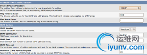

How do I configure SNMP data collection?
  SNMP can be used to monitor server traffic. Once installed login to cacti.
=> Click on Devices
  => Select Localhost
  => Make sure SNMP options are selected as follows:
DSC0001.png Fig.01: SNMP configuration
  Finally, click on Save button.

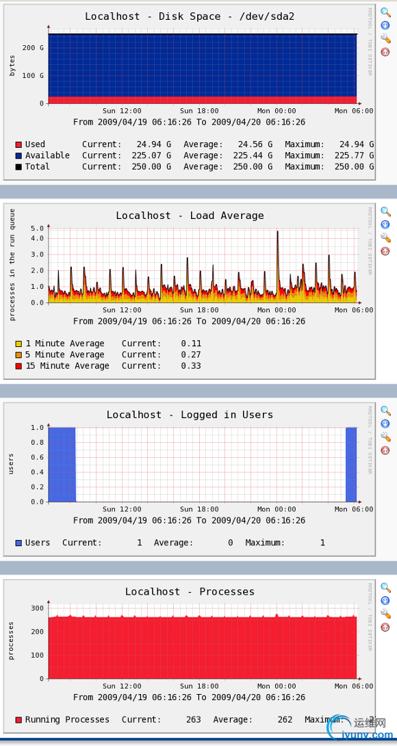

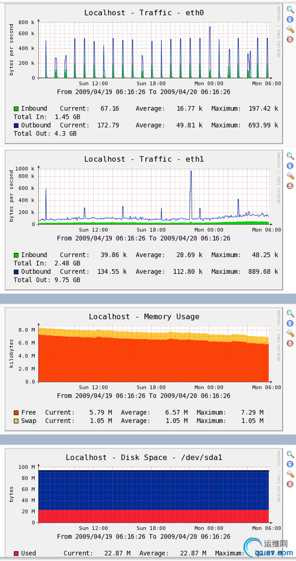

How do I view graphs?
  To view graphs click on Graphs tab. Here is sample graph from one my own box:
DSC0002.png Fig.02: Cacti in Action - Memory, CPU and Network Usage
(Fig.02: Cacti in action)
Fig.03: Cacti in Action Disk, Load average and User stats
