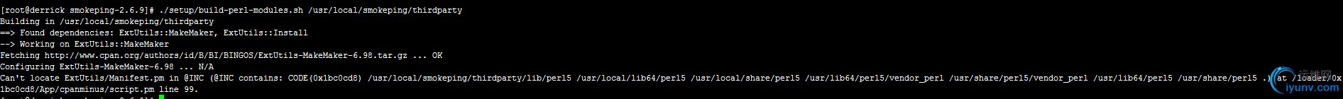

  ##如果是第一次安装smokeping程序,一般会出现报错,说没有perl模块支持,需要安装模块后在执行安装程序##
  1 ./setup/build-perl-modules.sh /usr/local/smokeping/thirdparty #根据报错提示安装perl模块
1 则需要下载安装perl-devel 和perl-ExtUtils-Embed Centos 系统可直接yum install perl-devel perl-ExtUtils-Embed -y (总之,提示少什么插件你就安装什么插件)安装后再执行./setup/build-perl-modules.sh /usr/local/smokeping/thirdparty2

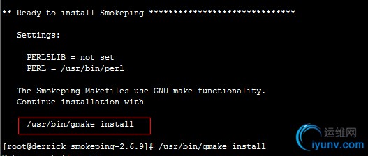

  ###### 此时,安装成功后,会提示编译,按照要求编译 #######
  1 /usr/local/gmake install
  ##############至此,程序已经初步安装完成###################

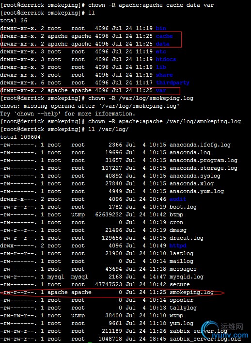

  2、给刚刚创建的文件和目录授予apache权限
1     cd /usr/local/smokeping
2     chown -R apache:apache cache data var
3     chown -R apache:apache /var/log/smokeping.log
  执行完后ls 查看一下结果是否正确:

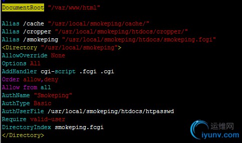

  四、修改apache配置
1 vim /etc/httpd/conf/httpd.conf
2 ####在DocumentRoot “/var/www/html” 这一行下添加如下代码:
3 Alias /cache "/usr/local/smokeping/cache/"
4 Alias /cropper "/usr/local/smokeping/htdocs/cropper/"
5 Alias /smokeping "/usr/local/smokeping/htdocs/smokeping.fcgi"
6 <Directory "/usr/local/smokeping">
7 AllowOverride None
8 Options All
9 AddHandler cgi-script .fcgi .cgi
10 Order allow,deny
11 Allow from all
12 AuthName "Smokeping"
13 AuthType Basic
14 AuthUserFile /usr/local/smokeping/htdocs/htpasswd
15 Require valid-user
16 DirectoryIndex smokeping.fcgi
17 </Directory>

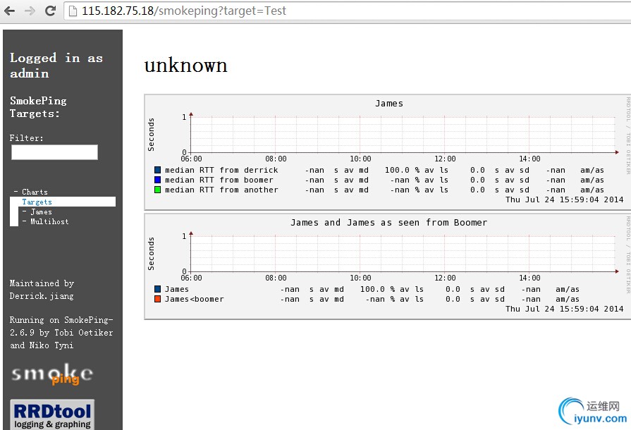

  八、打开web界面测试
  ### 如果返回 “500”错误  说明selinux 选项没有关闭 ###
1 vim /etc/sysconfig/selinux
  改成 Selinux=disable或者selinux=permissive
