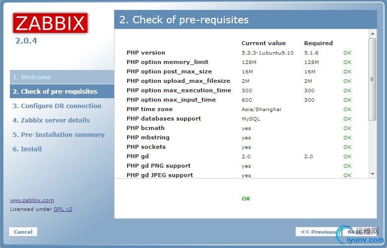

  2.11 配置PHP
$ sudo vi /etc/php5/apache2/php.ini
1max_execution_time = 300
2max_input_time= 600
3post_max_size= 16M
4date.timezone = Asia/Shanghai
  2.12 重启Apache

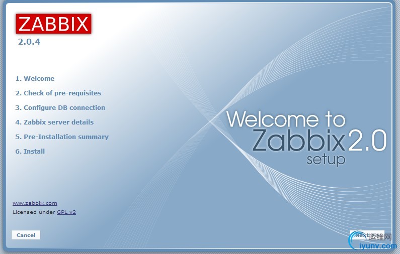

  2.15 打开网页安装向导
地址:http://10.6.1.181/zabbix
账号:Admin
密码:zabbix

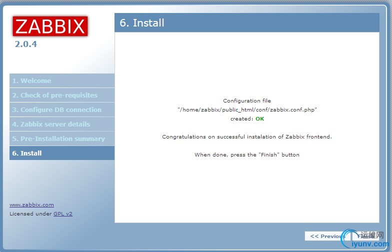

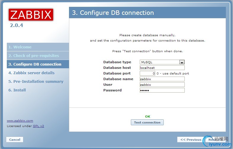

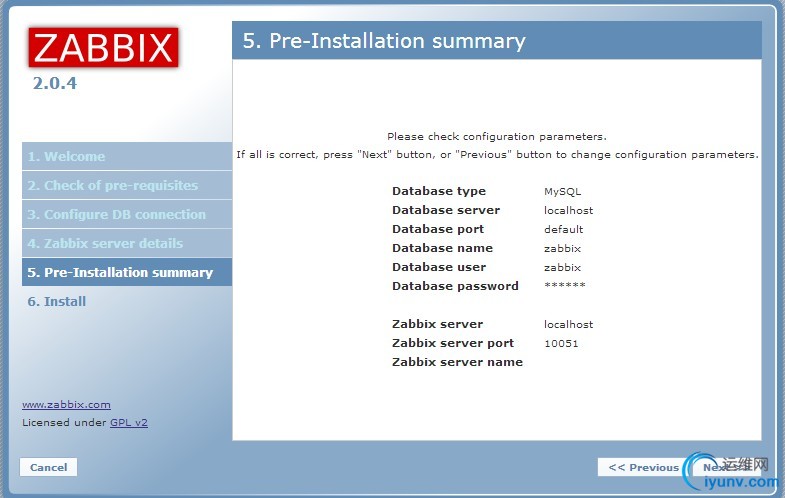

  相关界面截图如下:
  创建数据库连接文件
$ vim /home/zabbix/public_html/conf/zabbix.conf.php
01<?php
02// Zabbix GUI configuration file
03global $DB;
04
05$DB['TYPE'] = 'MYSQL';
06$DB['SERVER'] = 'localhost';
07$DB['PORT'] = '0';
08$DB['DATABASE'] = 'zabbix';
09$DB['USER'] = 'zabbix';
10$DB['PASSWORD'] = 'zabbix';
11
12// SCHEMA is relevant only for IBM_DB2 database
13$DB['SCHEMA'] = '';
14

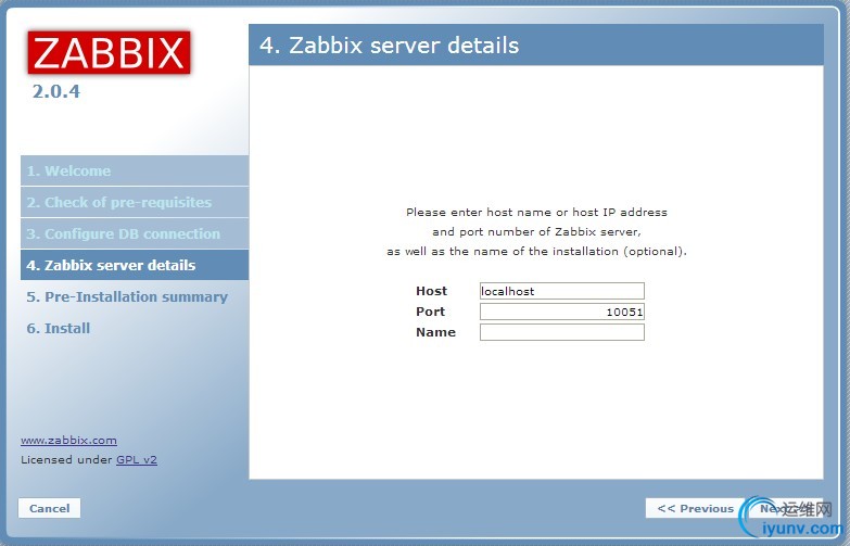

15$ZBX_SERVER = 'localhost';
16$ZBX_SERVER_PORT = '10051';
17$ZBX_SERVER_NAME = '';
18
19$IMAGE_FORMAT_DEFAULT = IMAGE_FORMAT_PNG;
20?>

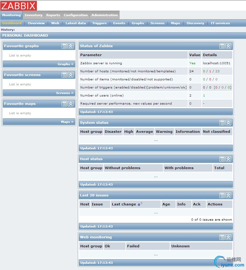

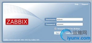

  接着,就可以登录到Zabbix系统的主界面
  至此,Zabbix的Server端已经部署完成,接下来我们在zabbix-client-1上部署agent。
