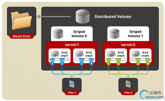

  第四,分佈式条带卷(復合型)
  分布式条带卷条带文件在集群中的两个或两个以上的节点。为了达到最佳效果,你应该使用分布式条带卷的要求是扩展存储和高访问非常大的文件的并发环境是至关重要的。(簡介:分布式的条带卷,volume中brick所包含的存储服务器数必须是stripe的倍数(>=2倍),兼顾分布式和条带式的功能。每个文件分布在四台共享服务器上,通常用于大文件访问处理,最少需要 4 台服务器才能创建分布条带卷。)
  (Distributed striped volumes stripes files across two or more nodes in the cluster. For best results,you should use distributed striped volumes where the requirement is to scale storage and in high concurrency environments accessing very large files is critical.
  Note
  The number of bricks should be a multiple of the stripe count for a distributed striped volume.)
  Create the distributed striped volume:
  # gluster volume create NEW-VOLNAME [stripe COUNT] [transport [tcp |
  rdma | tcp,rdma]] NEW-BRICK...
  For example, to create a distributed striped volume across eight storage servers:
  # gluster volume create test-volume stripe 4 transport tcp server1:/exp1 server2:/exp2
  server3:/exp3 server4:/exp4 server5:/exp5 server6:/exp6 server7:/exp7 server8:/exp8
  Creation of test-volume has been successful
  Please start the volume to access data.

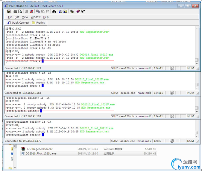

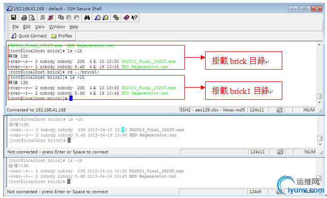

  第六, 条带復制卷(復合型)
  条带復制卷条带数据在复制集群中的砖。为了达到最佳效果,你应该使用条纹复制卷在高并发环境下并行访问非常大的文件和性能是至关重要的。在此版本中,这种类型的卷配置仅支持地图减少工作量。
  (Striped replicated volumes stripes data across replicated bricks in the cluster. For best results, you should use striped replicated volumes in highly concurrent environments where there is parallel access of very large files and performance is critical. In this release, configuration of this volume type is supported only for Map Reduce workloads.
  Note
  The number of bricks should be a multiple of the replicate count and stripe count for a striped replicated volume.)
  Create a striped replicated volume :
  # gluster volume create NEW-VOLNAME [stripe COUNT] [replica COUNT]
  [transport [tcp | rdma | tcp,rdma]] NEW-BRICK...
  For example, to create a striped replicated volume across four storage servers:
  # gluster volume create test-volume stripe 2 replica 2 transport tcp server1:/exp1
  server2:/exp2 server3:/exp3 server4:/exp4
  To create a striped replicated volume across six storage servers:
  # gluster volume create test-volume stripe 3 replica 2 transport tcp server1:/exp1
  server2:/exp2 server3:/exp3 server4:/exp4 server5:/exp5 server6:/exp6

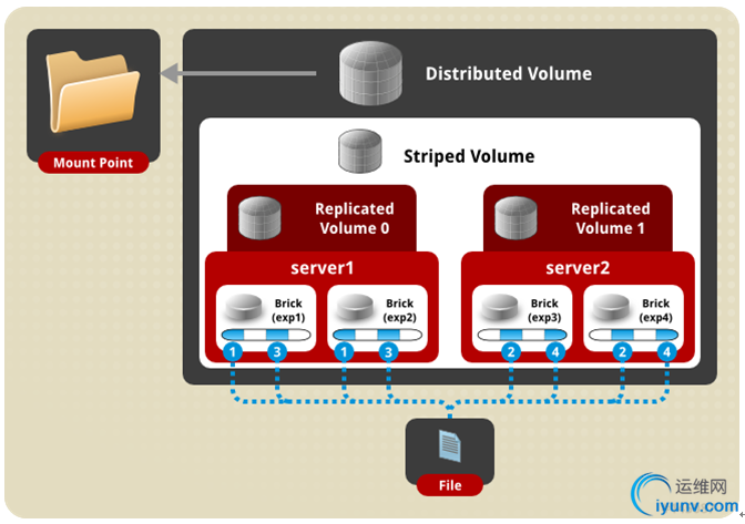

  第七,分布式条带復制卷(三種混合型)
  分布式条带复制卷分布条带数据在复制砖集群。为了获得最佳效果,你应该使用分布在高并发的条带复制卷环境下并行访问非常大的文件和性能是至关重要的。在此版本中,这种类型的卷配置仅支持地图减少工作量。
  (Distributed striped replicated volumes distributes striped data across replicated bricks in the cluster. For best results, you should use distributed striped replicated volumes in highly concurrent environments where parallel access of very large files and performance is critical. In this release,configuration of this volume type is supported only for Map Reduce workloads.
  Note
  The number of bricks should be a multiples of number of stripe count and replica count for adistributed striped replicated volume.)
  Create a distributed striped replicated volume using the following command:
  For example, to create a distributed replicated striped volume across eight storage servers:
  server2:/exp2 server3:/exp3 server4:/exp4 server5:/exp5 server6:/exp6 server7:/exp7
  server8:/exp8
