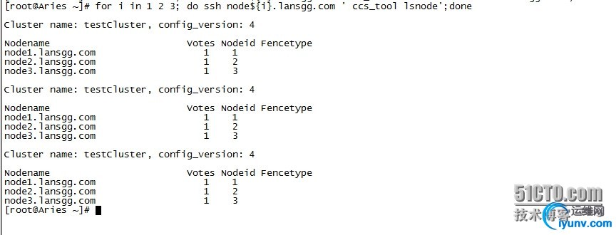

查看已经添加完成的节点及相关信息:
[iyunv@Aries ~]# for i in 1 2 3; do ssh node${i}.lansgg.com ' ccs_tool lsnode';done

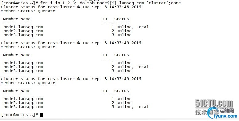

查看集群状态信息:
[iyunv@Aries ~]# for i in 1 2 3; do ssh node${i}.lansgg.com 'clustat';done

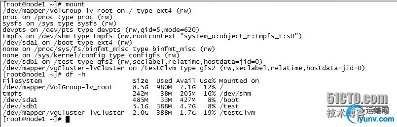

新建目录进行文件系统挂载
[iyunv@Aries ~]# for i in 1 2 3 ; do ssh node${i}.lansgg.com 'mkdir /test ' ;done
[iyunv@node1 ~]# mount /dev/sdb1 /test/
[iyunv@node1 ~]# echo "test" > /test/test.tt

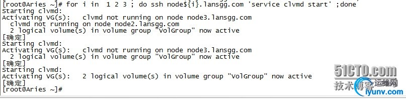

四、配置使用CLVM(集群逻辑卷)
在RHCS集群节点上安装lvm2-cluster
[iyunv@Aries ~]# for i in  1 2 3 ; do ssh node${i}.lansgg.com 'yum -y install lvm2-cluster ' ;done
在RHCS的各节点上,为lvm启用集群功能
[iyunv@Aries ~]# for i in  1 2 3 ; do ssh node${i}.lansgg.com 'lvmconf --enable-cluster' ;done
为RHCS各节点启动clvmd服务
[iyunv@Aries ~]# for i in  1 2 3 ; do ssh node${i}.lansgg.com 'service clvmd start' ;done

格式化逻辑卷 为 gfs
[iyunv@node1 ~]# mkfs.gfs2 -p lock_dlm -j 2 -t testCluster:lvCluster /dev/vgCluster/lvCluster
挂载逻辑卷 到 /testClvm
[iyunv@Aries ~]# for i in  1 2 3 ; do ssh node${i}.lansgg.com 'mkdir /testClvm' ;done
[iyunv@node1 ~]# mount /dev/vgCluster/lvCluster /testClvm/
[iyunv@node2 ~]# mount /dev/vgCluster/lvCluster /testClvm/
[iyunv@node3 ~]# mount /dev/vgCluster/lvCluster /testClvm/
Too many nodes mounting filesystem, no free journals
# 发现node3挂载不了,因为刚才创建了2个journal,需要再添加一个
[iyunv@node1 ~]# gfs2_jadd -j 1 /dev/vgCluster/lvCluster
Filesystem:            /testClvm
Old Journals           2
New Journals           3
再次node3挂载
[iyunv@node3 ~]#
