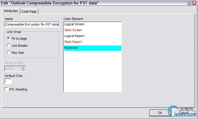

To view them, you need to create and apply an OCE text style.  Go the the text styles view, right click and choose new.  Set it up as shown below:
Make sure you visit the code page tab and turn off the Unicode, choose "other", and choose #48 "Outlook Compressible Encryption".  Once you have created the code page, click ok and then select that newly created code page.  When you do, the data will be viewed through this code page and the gibberish will snap into clear text as shown below.

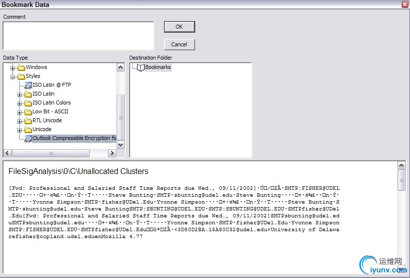

Select any text you wish to bookmark, right click and choose to bookmark the data as seen below.
Once you are in the bookmark dialogue box, the OCE code page that you just created is now available as a view type.  Select that view type and your bookmarked data will have the OCE code page applied and you have now successfully search for, located, and bookmarked OCE (PST data) in the unallocated clusters.  It's all made possible via the OCE code page.
