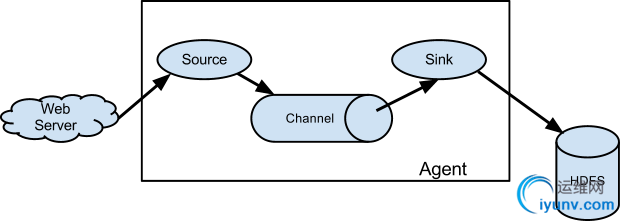

  Flume有三个组件:Source、Channel 和 Sink。在源码中对应同名的三个接口。
  When a Flume source receives an event, it stores it into one or more channels. The channel is a passive store that keeps the event until it’s consumed by a Flume sink.

  通过ChannelProcessor, Flume可以实现下面的消息流

  A channel connects a Source to a Sink. The source acts as producer while the sink acts as a consumer of events. The channel itself is the buffer between the two.
  A channel exposes a Transaction interface that can be used by its clients to ensure atomic put and take semantics. This is necessary to guarantee single hop reliability between agents. For instance, a source will successfully produce an event if and only if that event can be committed to the source's associated channel. Similarly, a sink will consume an event if and only if its respective endpoint can accept the event. The extent of transaction support varies for different channel implementations ranging from strong to best-effort semantics.
  Channels are associated with unique names that can be used for separating configuration and working namespaces.
  Channel连接起了Source和Sink。Source相当于消息的生产者,Sink相当于消息的消费者。Channel相当于二者之间的缓冲层。
  更重要的是,Channel提供了Transaction的机制,来确保了消息的可靠传递。
  Flume uses a transactional approach to guarantee the reliable delivery of the events. The sources and sinks encapsulate in a transaction the storage/retrieval, respectively, of the events placed in or provided by a transaction provided by the channel. This ensures that the set of events are reliably passed from point to point in the flow. In the case of a multi-hop flow, the sink from the previous hop and the source from the next hop both have their transactions running to ensure that the data is safely stored in the channel of the next hop.
  Flume使用了事务来保证消息的可靠传递。Source和Sink对于消息的存储和获取都被包装在由Channel提供的事务中。一个消息只有被成功存入下一个agent的Channel(或者至最终的存储位置),才会被从当前的channel中删除。这就使用在消息流中,消息可以可靠地从一点传送到另一点。在一个包括agent间传递的消息流中,前一个agent的sink和下一个agent的source都有各自的事务,来保证消息被安全存入下一个agent的channel.
