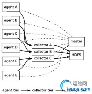

  1.1. Architecture
  Flume’s architecture is simple, robust, and flexible.
  The graph above shows a typical deployment of Flume that collects log data from a set of application servers. The deployment consists of a number of logical nodes, arranged into three tiers. The first tier is the agent tier. Agent nodes are typically installed on the machines that generate the logs and are your data’s initial point of contact with Flume. They forward data to the next tier of collector nodes, which aggregate the separate data flows and forward them to the final storage tier.
  Logical nodes are a very flexible abstraction. Every logical node has just two components - a source and a sink.

3.5. Tiering Flume Nodes: Agents and Collectors
  A simple network connection is abstractly just another sink. It would be great if sending events over the network was easy, efficient, and reliable. In reality, collecting data from a distributed set of machines and relying on networking connectivity greatly increases the likelihood and kinds of failures that can occur. The bottom line is that providing reliability guarantees introduces complexity and many tradeoffs.
  为什么要给flume nodes分层, 读完直接写到存储层不行吗, 为什么要分成agents和collectors
  首先, agent工作的系统, 往往不是很稳定的, 有各种fail的可能, 而且在存储前, 如果对数据做些预处理和整合应该更有效一些.

4.2. Multiple Collectors
4.2.1. Partitioning Agents across Multiple Collectors
  The preceding graph and dataflow spec shows a typical topology for Flume nodes. For reliable delivery, in the event that the collector stops operating or disconnects from the agents, the agents would need to store their events to their respective disks locally. The agents would then periodically attempt to recontact a collector. Because the collector is down, any analysis or processing downstream is blocked.
  当一个collector fail了, agent可以把数据在本地做缓存, 直到collector恢复了, 继续发送.
  这个明显有点傻, 不是有其他的collector吗, 这个坏了用其他的好了, 人为去调整, Manually Specifying Failover Chains
