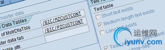

  Using transaction code RSD1, maintain the InfoObject as an ‘InfoSource with Direct Update'.
  Choose an Application Component after enabling the corresponding checkbox. Depending on the InfoObject properties, this will allow loading attribute, text and hierarchy data for the characteristic.
  Mark the characteristic as an InfoProvider by assigning it to an InfoArea. The InfoObject will then be displayed in the InfoProvider tree in the Data Warehousing Workbench.
  Enable the characteristic as an export data source. This allows the extraction of the InfoObject data using the data mart interface.

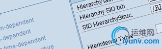

Obviously you will also need to specify that the InfoObject contains hierarchies. The exact settings, like time-dependent and versions, affect the tables being generated and this will in turn require specific coding in the datasource enhancement afterwards.
Image 6 InfoObject with hierarchies

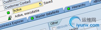

The next step is generating an export datasource. This will in fact generate a data mart for extracting attributes (M), texts (T) and hierarchies (H), depending on the InfoObject settings. Go to the ‘Data Warehousing Workbench' (transaction code RSA1) and right-click on the InfoObject. In the context menu, choose ‘Additional Functions' > ‘Generate Export DataSource'. The datasource typically gets the technical name 8 <‘M', ‘T' or ‘H'> and can be found in the application component called ‘Data Marts Master Data' (DM-IO) after replicating this application component in the datasources area of the Data Warehousing Workbench (remember to check the BW system itself as a source system on the top left of the screen). If this specific application component is not yet activate in your BW system, the new datasource can be found in the application component ‘Unassigned Nodes' (NODESNOTCONNECTED).  Now we have a hierarchy datasource and we can link it to our InfoObject hierarchy via transfer rules. Hierarchy datasources are not yet supported using SAP Netweaver 2004s/7.0 technology and therefore we still need to use a SAP BW 3.5 datasource and transfer rules to build the connection. In fact we connect the InfoObject to itself. In order to create transfer rules, right-click on the hierarchy and use the context menu to go to ‘Additional Functions' > ‘Create transfer rules'. Next we need to select the correct source system. As we want to employ the export datasource we created earlier, select the same SAP BW system as the one you are logged on to. A list of all available datasources for that source system will pop up. Select the export datasource we created earlier. It should have the name 8 <‘H'>. The transfer rules are generated automatically and in fact they establish the link between the export datasource and the InfoObject hierarchy.

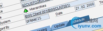

  Create a new Infopackage for the hierarchy datasource by right-clicking on the datasource and selecting ‘Create Infopackage…'. Give the Infopackage a descriptive name and refresh the ‘available hierarchies from OLTP'. This will load all hierarchies that are available in the source. As we only created one dummy hierarchy, this will be the only hierarchy we can extract. Select this dummy hierarchy and save the Infopackage. It is advisable to rename the target hierarchy.
Image 10 InfoPackage

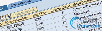

Image 12 Structure ROSHIENODE
click to enlarge  Note that not all fields are required in order to successfully build your hierarchy. Depending on the hierarchy properties in the InfoObject settings, other fields and even other tables can become required.
  The above example hierarchy is quite straight-forward and therefore it is sufficient to populate only a selection of fields of the table C_T_HIENODE; NODEID, IOBJNM, NODENAME, TLEVEL and PARENTID.

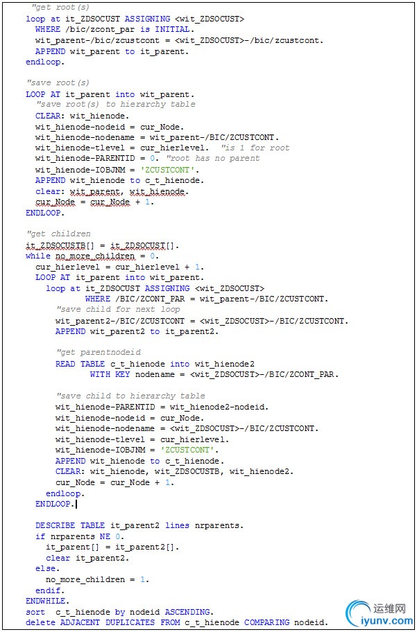

  Let's take a closer look at the coding. As the include ‘ZXRSAU04' is executed each time a hierarchy datasource is executed, it is recommended to make a distinction between the datasources.
  This procedure makes sure that your coding is not executed when other hierarchy datasources are executed.
  The first thing to do in the ABAP program is to delete the dummy hierarchy data from the internal table C_T_HIENODE.
  Now we can set the hierarchy description ‘Customer Contacts'.
  Next we need to fetch the hierarchy data from the DSO into an internal table.
  For each node we need to find out the hierarchy level and the node ID of its parent. Make sure all relevant fields are filled. As mentioned earlier, this varies according to the InfoObject properties. The easiest way is to work top-down and start with the root(s). A root is a node that does not have a parent. A hierarchy can consist of multiple roots. Once we have identified the roots, we can search for its children. Then we need to search for the children of the children. Every record is saved in the table C_T_HIENODE. We continue this process until every record is processed.
  Now that we have completed the datasource enhancement, the last step is executing the Infopackage. This will populate the hierarchy based on the dataset that we previously loaded into a DSO. The complete loading procedure can be automated by implementing a process chain.
