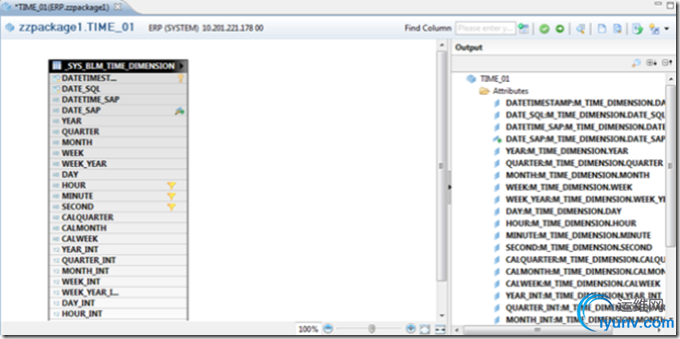

  5. Create an Attribute view
  • Right Click on Attribute View > New > Attribute View.
  6. Enter “TIME_01” for the name of the view
  • Select Time ->Gregorian.
  • For the Granularity select “Date”
  • Click on Auto Create.
  • Click Finish.
  7. As a result you will see the Dimensions table with the generated Attributes. Optionally you can remove any attribute fields that are not needed.
  8. Save the view first. Right Click on the Attribute View > Activate.
  9. Right Click on the Attribute View > Preview.
