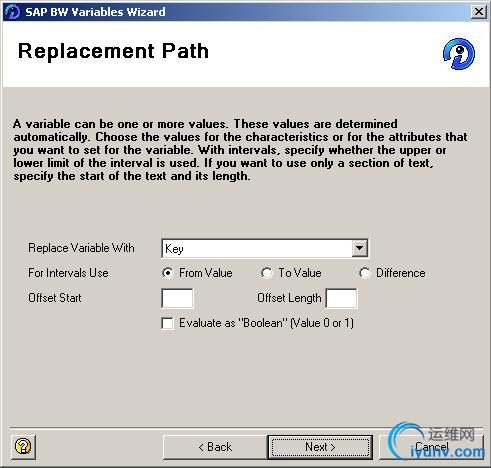

  • In the Replacement Path screen (Figure 5) select Key in the Replace Variable with field. Leave all the other options as they are (The offset values will be set automatically).
    Click the Next Button.

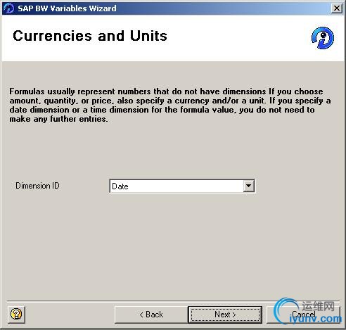

  • In the Currencies and Units screen (Figure 6) select Date as the Dimension ID.
    Click the Next button.
