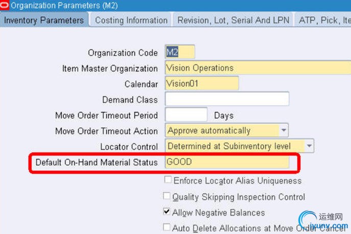

   How to activate onhand level material status control
  Activate On-hand Level Material Status Tracking for one organization, Run concurrent request ‘ActivateOnhand Level Material Status Tracking’
  NOTE: Once an organization is activated as onhand status tracked itcannot be reverted back. If you have accidentally Run Activate On-Hand Material Status, Please refer to Note1198443.1, The following Enhancement Request was logged suggesting that users should be allowed to deactivate the status:  Bug8626159 - ER to allow de-activate: Allow user to deactivate / de-activate 12.1 Feature: On-hand Status Tracking

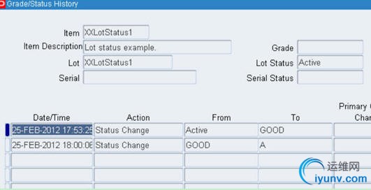

  How To modify onhand material status
  Once clicking on the lower level onhand record then going to Tools > Status Update
  How To Inquire On Onhand Material Status Updates And History
  • For Lot controlled item, we cancheck onhand status update history via
  Lot Number Form > View Genealogy > Material Transaction Tab > Grade/Status
  • Material Status History Report
  • SQL query to check status history

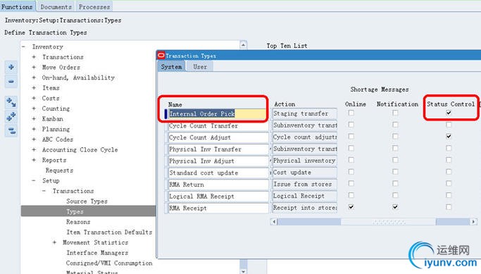

  In Material Status Form, The specific transaction type is not in the Allowed/Disallowed txn type list, Howcan I make my transaction type into Allowed/Disallowed txn type list?
  You need enable ‘Status Control’ for the transaction type in Transaction Types Form.
