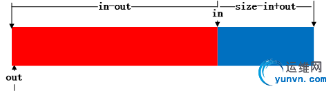

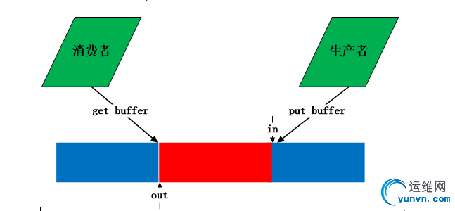

  put和get在调用__put和__get过程都进行加锁,防止并发。从代码中可以看出put和get都调用两次memcpy,这针对的是边界条件。例如下图:蓝色表示空闲,红色表示占用。(1)空的kfifo, 19004528-29ad8d3e5c0148f4aba3b7558bb622ab.jpg (2)put一个buffer后 19004655-2526b4e6501d4c318641e2df7c667839.jpg (3)get一个buffer后(4)当此时put的buffer长度超出in到末尾长度时,则将剩下的移到头部去 19005831-6bdbb3a00a7f4b04a997b7c7c569ae81.jpg 3、测试程序 仿照kfifo编写一个ring_buffer,现有线程互斥量进行并发控制。设计的ring_buffer如下所示:/**@brief 仿照linux kfifo写的ring buffer

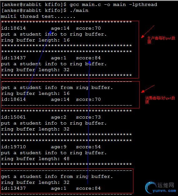

采用多线程模拟生产者和消费者编写测试程序,如下所示:/**@brief ring buffer测试程序,创建两个线程,一个生产者,一个消费者。
* 生产者每隔1秒向buffer中投入数据,消费者每隔2秒去取数据。
*@atuher Anker  date:2013-12-18
#include "ring_buffer.h"
#include <pthread.h>

void * consumer_proc(void *arg)
    struct ring_buffer *ring_buf = (struct ring_buffer *)arg;
    student_info stu_info;
    while(1)
    sleep(2);
    printf("------------------------------------------\n");
    printf("get a student info from ring buffer.\n");
    ring_buffer_get(ring_buf, (void *)&stu_info, sizeof(student_info));
    printf("ring buffer length: %u\n", ring_buffer_len(ring_buf));
    print_student_info(&stu_info);
    return (void *)ring_buf;
void * producer_proc(void *arg)
    time_t cur_time;
    while(1)
    time(&cur_time);
    srand(cur_time);
    int seed = rand() % 11111;
    printf("******************************************\n");
    student_info *stu_info = get_student_info(cur_time + seed);
    printf("put a student info to ring buffer.\n");
    ring_buffer_put(ring_buf, (void *)stu_info, sizeof(student_info));
    sleep(1);

    printf("multi thread test.......\n");
    produce_pid  = producer_thread((void*)ring_buf);
    consume_pid  = consumer_thread((void*)ring_buf);
    pthread_join(produce_pid, NULL);
    pthread_join(consume_pid, NULL);
    ring_buffer_free(ring_buf);
    free(f_lock);
    return 0;
测试结果如下所示: 19011447-6807de1a701d4023ba4aee67fac5fbef.jpg
