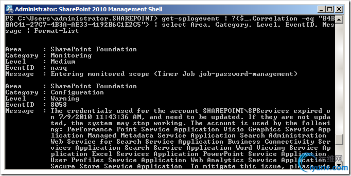

  You might want to be more precise and get more specific details out of your query, then you can try something like this:
  get-splogevent | ?{$_.Correlation -eq "<GUID>"} | select Area, Category, Level, EventID, Message | Format-List
  This will give you the details about your specific error like this with some juicy details:
  Finally if you would want these messages to be put into a text or log file instead, you could just add the classic “> C:Awesome.log” after the command like this:
  get-splogevent | ?{$_.Correlation -eq "<GUID>"} | select Area, Category, Level, EventID, Message | Format-List > C:Awesome.log

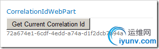

  Then from wherever in your code you can simply call it by using this approach:
protected  void  Button1_Click(object  sender, EventArgs  e)
     Label1.Text = CorrelationId .GetCurrentCorrelationToken().ToString();
  (Normally you might want this in a try/catch statement or something like that)
